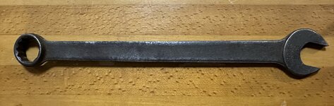

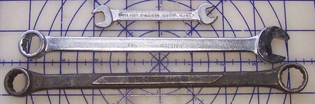

There seems to be some confusion regarding these types of products which were produced both by "Duro Chrome" and "Indestro" concurrently.
Duro offered a different product selection than Indestro, part of which included their wrenches with the "dart" design on the beams.
Indestro did not call their "combination wrench" a "combination wrench" at first. For that matter, nobody did. Somebody here sent me down a rabbit hole quite a while back with the question "Who made the first combination wrench?"
When you start searching for the answer to that question, you'll discover that nobody called them "combination wrench" until they'd been on the market for two decades.
They are "2-Way Box End Wrenches" in the 1935, 1937, and 1948 Indestro catalog. Not until the 1952 catalog No. 20 (page 29) does Indestro refer to them as a "Combination Wrench".
The manufacturer's own nomenclature is part of the cause of the confusion here.
All of these wrenches - Duro's "020" (or "Combination Box and Open End Wrenches", as they are called in the 1935 Duro catalog); Duro's "Combination Box Open End Wrenches" (as they are called in the 1940 and 1947 Duro catalogs); Duro's "Combination Wrenches" (as they are first referred to in Duro's 1951 catalog on page 30); and the various iterations of Indestro's "SuperQuality" "2-Way Box End Wrenches" and "Combination Wrenches" (mentioned above); and their succeeding counterparts simply branded "Duro Chrome" or "Indestro Super" went through evolutions in design, the earlier versions having thinner beams and heads than their later counterparts.
However, it is worth noting that none of the early "SuperQuality" or the early Duro "020" wrenches (as they are referred to by AA) were advertised or marketed as "thin".
There exists no extant documentation making any claims in respect to the thickness of the beams or the heads.
Here's my request:
Get out your calipers (or micrometer) and give me beam and head thickness on your early "SuperQuality" combo or Duro "dart" combo. I don't own any of those - all of mine are the later "Indestro Super" (see post #3086.)
In order not to clutter up the thread, shoot them to me via P/M please.
Thanks.

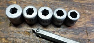

Found a Duro ratchet and a couple of Duro tools to go with it today:
The ratchet is broached for a 1/4" drive plug at each end, with a 1/2" 12pt box end opposite the ratchet. It also has a smaller square broach by the BE end.
Tool mounted on the wrench is Duro Chrome. It's made from two pieces and I don't know what it's for. Some kind of locknut? The only thing I have that it might fit would be the tang nut on an old stacked-leather knife handle. The tool on the right is Duro Metal. Again, not sure what it's for--I don't often see 7/32" square-heat nuts with domed shoulders.
The other tools are Bonney and Hinsdale.

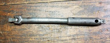

Happy to find this wartime 10-1/2" 666D "Swing-Head Handle" at the flea market this morning. Double-duty as an extension with that male drive stud on the end. It did not come with a cross-bar, but I have a pile of just-in-case orphans.

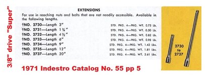

GaryM909 said:
I have never seen a 5” extension before.
Long prior to their introduction of their "Select" and "Classic" lines, Indestro's 1935 catalog shows their longer 3/8" drive extension, model 2732, was marketed as being 4-1/2" inches in length:
Indestro 2731 2732 2733 3233 3.8 dr extensions - 1935 Indestro catalog pp 15.jpg
By 1971, they had expanded their selection of extensions, offering their 3/8" drive model 2733 in a 6-inch length:
Indestro 2730 2732 2732 2733 2734 2735 2737 3.8 dr extension 1971 Indestro catalog No. 55 pp 5.jpg
Generally speaking, for most sockets and drive accessories, you can replace "27" with "62" and get the same item in Indestro; the "27" being their "Super" line, and the "62" being the "Select" or "Classic" line.
But oddly, the 1971 Indestro "Classic" catalog No. 10 shows their medium-length 3/8" drive extension as being 5 inches in length:
Indestro 6230 6233 6235 3.8 dr extension 1971 Indestro Classic catalog No. 10 pp 9.jpg
First time I've ever seen that question. I'm going to have to go dig out sets now and compare extensions to satiate my curiosity.
Your 7790MM set dates from the 1970s. It does not appear in the 1971, 1982, or 1984 price sheet so I have to assume it was one of their "promotional" sets.
(Socket part numbers should be 46010, 46011. 46012, 46013, 46014, 46015, 46016, 46017, correct?)

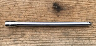

I picked up this 3/8” metric set last week. It’s missing the 13mm and the 17mm sockets as well as the 5” extension. I have never seen a 5” extension before. Plastic case with a broken latch of course. There is also a 8mm and 9mm included. All 12 point sockets. I am not sure of the year
Here's a, 1/2" X 5" extension, make and vintage unknown:
It's the first I've seen.
39,488
There are lots of 5" extensions in 1/2" drive - fewer in 3/8" (None in 1/4" that I'm aware of):
