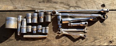

Since we are forced to take some time away from going to garage and estate sales, I ordered this mixed tool lot off of eBay. It was difficult to determine brands in the listing but the bulk of the tools turned out to be Indestro, along with a few Western Auto Wizard sockets. Only four pieces turned out to be Duro.
D-I 5/8” #1220 socketIMG_0353.jpegIMG_0352.jpeg
i’ll hang on to the 1/4” drive Indestro pieces and send the rest somewhere they might be appreciated.

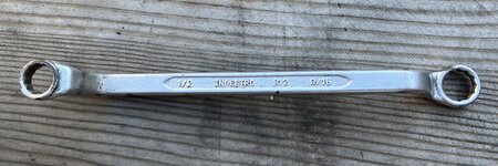

39,504
Picked up this Indestro Super Allen Socket today -interestingly it's marked "Not Guar.". Is that because the Allen shank's fails so much, or was this wartime/gov issue?
