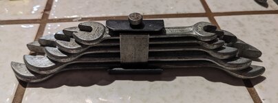

Here is a grab from yesterday’s estate sale, an Indestro 0930-5P wrench set. Offered from 1952 to 1971, per the resources in ITCL, it was found sorta loose, with a Blackhawk Hexite included under the Klip instead of the largest wrench. Grabbed all the pieces, tossed them in my bag. Saw the back of the Klip said 5P, hoped it meant 5 pieces, cuz I quit looking then.
PXL_20250201_023351171-X3.jpgPXL_20250201_023331121-X3.jpgPXL_20250201_023233678-X3.jpg
13,421
yes. 5 pieces.
1959 catalog No. 22 - page 30 - 0930-5P - same as the 930-5P, but without polished heads :whistle:
Oops, I knew that, guess I forgot to link the image from the 1952 catalog showing that, listed as a budget line. Sorry for the extra work.

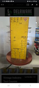

Historyworker
Sep 11, 2023
22
Indestro store display. Not mine but I thought it was pretty cool. It's an auction lot ending tomorrow. Wish I had the space for it.

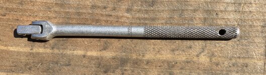

Duro Chrome from Sunday's flea market. Ignore the Mac starter wrench on the left.
2733 is the only marking on the 3/8 drive extension. It is unplated. Perhaps WWII?
Duro-Chrome 2213S combo 3/8
Duro-Chrome 2214S combo 7/16
Duro-Chrome 2013 DBE circle-DC, 9/16 x 5/8
Chrome X Quality 1721 DOE 5/16 x 3/8 "Vanadium Steel" Made by Duro-Indestro for Western Auto.
29,774
2733 is an Indestro part number. Duro Chrome part number would be 4433.
Don would know better as to whether it's suitable for entry into a GMTK.
<edit> I cannot make out the detail in that image. Is the part number stamped on the shank of that extension? or on the drive end?

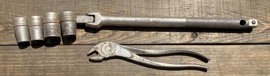

I’ve run across some Duro tools at recent estate sales. First some 1/2” drive sockets and a matching breaker bar with some battery pliers. IMG_1605.jpeg

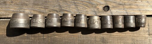

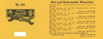

29,774
1920s or 1930s.
that's a model 112 "Nut and Rethreader" set.
The 110 "Nut and Tap Wrench" set has the SQUARE hole in the center to turn a TAP.
quite a find, especially with the original screw and nut.
  • Indestro 112 119 Nut and Rethreader Wrench set - 1935 Indestro catalog pp 26.jpg
