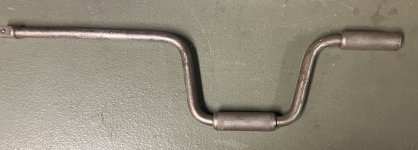

Long c speed wrench c-92 (1/2 drive made by snap on!)
Long c pliers (not a set I have)
long c 1/2 ratchet with pass through plug.

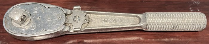

Here is a BE 3/8” drive ratchet. I’m hoping that it will respond to clean up efforts.

I cleaned and regreased this 3/8dr BE ratchet this morning (dropping the ball bearing in gravel only once). But putting it back together, I started to wonder about which end the drive should stick out. I put it on opposite of the way I found it, and I think the direction switch is a little awkward this way.
AA’s BE and NB rats that are similar are shown both ways. So are ones on this thread. The most convincing image is the catalog illustration posted by Rileysan, but it’s still just an illustration, and I’ve seen those with brand names in odd locations just to make them visible. EDIT - I take it back - that is a catalog photograph, so it must be right.
Opinions?
