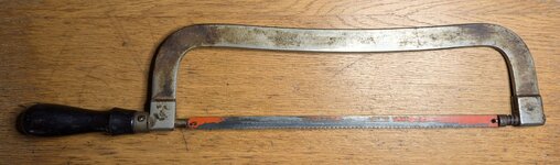

@d42jeep :
Can you get a picture of the bit of the #6 that goes between the handle and the frame to keep the blade from twisting when tightening it? Mine's missing.
16,718
Here are a couple pictures of the area in question. I’m not sure that there is anything to stop the blade from twisting when tightening. I guess you twist the blade straight after it’s adequately tensioned then tighten the knurled nut against the frame to keep it straight.
IMG_2081.pngIMG_2080.png.
13,466
I suspect, once you clean the threads a bit, and the surface where the nut meets the frame, it may thread easy enough to reduce twisting. On my coping saws, I need to hold the handle to prevent twisting as the tension goes up.

Thanks for the pic, @d42jeep ! With that, and finding the right indexed washer, I can fab that part.
@RTM : The threaded tensioner shaft has a groove cut in it:
With the crimp in the indexed washer and the dimples in the "socket" {making up terminology as I go), the tensioner and blade won't rotate and can be set to four different positions, corresponding to similar indecies at the other end of the blade.

I took it apart today for a closer look. It’s basically a thick flat washer with two notches pressed into it. If mine was missing I would find an appropriate flat washer, set it on a wooden block, find a nice dull cold chisel and a BF hammer and create the notches. IMG_4957.jpegIMG_4958.jpegIMG_4959.jpegIMG_4960.jpeg

Does your tensioner screw (again, making up names) not have the indexing groove like mine? I expected the washer to have a key to fit the groove. Uh, keyway....
The nut, BTW, has a concave end on it to retain the end of the blade. The other end--as you'll find when you take the blade off--has a notch cut in it so you have to tilt the blade to remove it. I guess they were really worried about the blade escaping. Because... runaway hacksaw blades....
16,718
It has the indexing groove and you could certainly be right about a missing key. It had a hard life before I found it. One could weld on a little bead to the washer to act as the key. It’s probably not that important to the operation of the saw. Once the knurled nut is tightened there isn’t any tendency for the blade to move.

It's pretty easy to tighten the blade enough just by holding onto the end of the blade while tightening the handle. I think a brass washer with the divots would do just fine.
I used the saw for the first time yesterday, with the blade that came on it. I had to rip a hard plastic tube in half down the middle for about four inches, then cut a couple of brackets from aluminum stock. Worked like a charm and the strange (to me) grip is very comfortable and controllable.

Hardware stores are all closed today, so I dug through my box of Assorted Weird Washers (TM) and found this:
Kinda thin, but should be a good proof-of-concept.
I first used a mini-die grinder to remove one of the flats, then, as Don suggested, I used a dull cold chisel and a block of wood to put the dimples in it, after using a center-finder to mark it. That left me with a taco shell, so I played around with a vise some and came up with this:
It works, but is very thin and flimsy. When the hardware stores reopen on Tuesday, I can look for a thicker keyed washer.

As I have nothing else to do today--I finished my chores this AM--and the county is full of tens of thousands (I kid you not) of tourons, I took my proof-of-concept model and made the real thing!
I did a LOT of searching for an internal tab washer in 3/8" ID. No luck whatsoever. Not even McMaster Carr wants to sell me 100 of them.
So I made my own. Going with Don's idea above, I found a 3/8" ID heavy galvy washer, soaked it in phos acid for a while to remove the zinc, put it on a copper plate and hit in one spot on the inside with the MIG welder, set to mid hot, slow feed. The gave me a tab. I then heated it to red hot to anneal it.
I did the same trick with the dull cold chisel as before, but instead of a wood block, I opened the jaws of one of my vices about 1/8" and used that as a die. Of course, this still resulted in a bit of a "taco shell" shape, but my DP vise has a slot in the jaws, so I put my two "peens" into the slot and tightened it down, flattening the washer nicely while preserving the two peens.
I figured I'd need to use a small file to make the weldment "tab" square, but it worked just fine the way it was.
I then heated it red-hot again and quenched it in used motor oil to both re-harden it and give it a nice, black finish.
The blade no longer tries to twist when I tighten it, and the saw is much closer to stock. I see that Don's washer has some knurling on the edge (coining?), but that just ain't going to happen unless I get really bored.

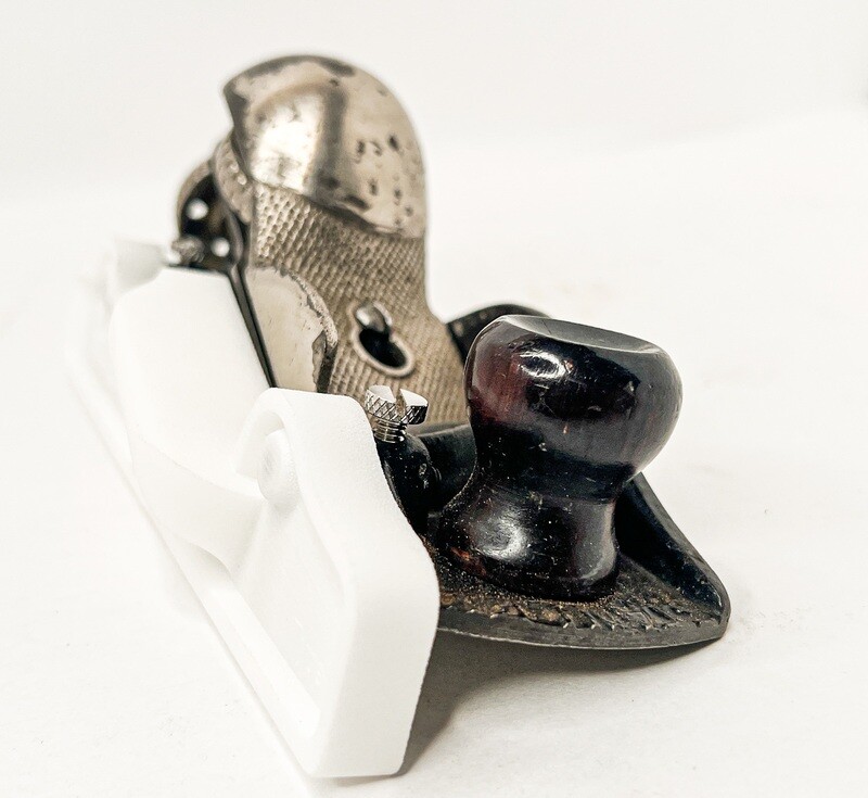

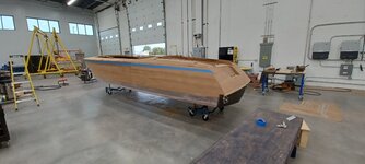

Sep 22, 2010
121
My Millers falls skew block plane I use for the boats we build. It’s great little plane and being it’s skew will not tear out as much with figured Mahogany
I have one too. Like you, I really like it. Found an auxiliary fence that might interest you.
hop up
Sep 22, 2010
121
@Eric Brown thank you for the link . I also own and use a lie Nielsen skew that has the fence. It’s a bit beefier then the falls but work both planes . I have been looking for an original one for the millers fall but may buy one of the 3d printed ones and cast one up in the shop out of brass. I did buy some brass to machine one out but casting it sounds like a lot more fun
