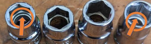

I'm referring to the bottom (or top?) of the socket cavity:

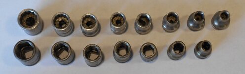

30,976
Someone more conversant on socket manufacturing processes would be more qualified to address the question.
I'm referring to the lip that is present at the bottom of both SK sockets. (old is shallower, new is deeper, both have a 'lip' -
@four.cycle,
You asked me to look at this. The only odd thing I see is that the socket on the very left with the shallow broaching seems to have an extra ledge or lip. The only time I have ever seen anything like that is for vintage spark plug sockets that had a hard rubber insert inside.
Otherwise, all those sockets look like fairly normal hot-forged sockets. The ledge or lip is where the broach stops. A socket blank has a round hole when it is first forged. It is broached when still hot with a die that forms the smooth, sharp teeth, corners, or points of final hex or double-hex shaped opening.
I have no idea why they'd do that, other than possibly cleaning up the kind of "flash" (for lack of a better term) that occurs on some sockets. (example below - top row.)
That kind of flash and leftover steel and chatter marks etc are usually seen on older cold-broached sockets where the final opening is made with a machine that mills or cuts the opening.

I **** at this - I'm referring to the lip that is present at the bottom of both SK sockets. (old is shallower, new is deeper, both have a 'lip' - I'll go back and look closer and see if I can grab a better pic):
I do not know what that extra machining is about, but yes, it does indeed look like an additional step was made in the making of those two pieces. I have no idea why they'd do that, other than possibly cleaning up the kind of "flash" (for lack of a better term) that occurs on some sockets. (example below - top row.)
bk
I think that is an extra step for clearance of the bolt/stud to allow the socket to slip on deeper.

RE: "A socket blank has a round hole when it is first forged. It is broached when still hot with a die that forms the smooth, sharp teeth, corners, or points of final hex or double-hex shaped opening."
I am interpreting that to mean that the round "lip" (that M635_guy is referring to) was already there prior to the broach being sent down the throat of the socket, correct?
I'm still not sure I get it. I'll go dig up some YouTube videos and see if I can make sense of it.... sometimes I can be pretty thick about some stuff. :lol:
30,976
As I said, I don't know what that extra ledge or lip is, except for the situation I described with spark plugs sockets with internal jackets, but no, I am assuming it was made when the broach was done by the same die that made the broach. Again, not sure why.
I see the same “lip” on some recent Apex sockets, both Gearwrench and SATA, but not all sizes 642C6642-AFB5-4E5C-AEFA-BB4B50C84F51.jpegA34810D3-DAED-48C2-961B-72D6257AF800.jpeg
Not all the new S-K sockets have it either in my set.
Hmmm... I kinda wonder if it does that at sizes common for dome/acorn-head nuts for a bit of clearance...
