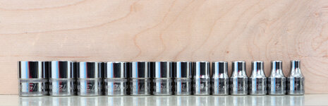

Got a 1/4" drive 4-15mm Caterpillar branded socket set recently:
This is my first modern Snap-On tool (I have a couple pre-50's pieces) and figured I would dip my toe in the water so to speak to see what the hype is about. Price was an affordable $60 vs SO's $230 list price. My local dealer was super nice to work with and I was able to pick them up 2 days after I called in the order, so that was great.
They appear functional but I'm scratching my head at how inconsistent stamping quality is. Decent Taiwanese sets are above this, let alone a "high end" USA brand with such a crazy reputation. Maybe SO dumps their factory seconds on CAT and Williams? Date stamps on these look to be mostly 2020 with a few 2018 and a 2016 but the differences don't correspond with that.
I was also surprised to see that the female square drive is just square and does not have off-corner engagement unlike pretty much any other modern tool. I don't know that it will make much of a difference in practice but it's still a pretty silly cost-cutting measure from the company that spams "flank drive" branding on everything.

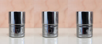

10mm compared to Nepros and Bahco
12mm compared to Ko-ken and Bahco
Stamping quality has a wide variety between different sockets; see knurling above
Upper ring stamped differently than lower ring on the same socket
Another socket stamped differently on different faces

Don’t quote me on this but I believe a Williams distributor posted on these boards that Williams (and I am assuming others) differs from Snap-on solely by not having any extra attention paid to the finish. So there will be marks and dings under the chrome or the chrome may be splotchy or even the stamping will be off or light or whatever. I believe that is how those sockets are able to stay so affordable versus the Snappys.
tamaraw
Jun 6, 2022
846
The Williams 1/4" sockets looks like they might be a different forging in pictures? I'm not sure since I don't own any.
No dings, marks, or chrome issues on these, just sloppy stampings on a few. Others are A+ perfect.
I suppose it is possible that SO has lower standards on the CAT production runs, but it's not like they would save big $$$ by having a mis-calibrated stamping machine. SO pricing is mostly just extra profit margin; It certainly doesn't take an extra $170 of manufacturing costs to get the stampings straight. EDIT: Actually looking at pictures online, the SO branded 1/4" sockets seem to have a similar stamping variance :LOL:
I do not regret the purchase and wouldn't try to return these, just sharing some unexpectedly funky manufacturing. I'll probably buy CAT again.

Interesting observations. I don't own the 1/4" CAT set yet. I've not noticed this on my 3/8" CAT set. I will have to look at them more closely tomorrow at work.
I will also have to inspect and report back when I buy any more CAT sockets (coming soon). All of my Snap On sockets are impact minus a few individuals.
From everything I've been told, seen/own and been able to research is CAT sources their CAT branded tools from both Snap On and Williams in terms of OEM. I have no idea how or why those decisions are made, or what tools are made by who or if that differs outside buying CAT. I also have no idea if quality changes between buying directly from Snap On/Williams or buying from CAT.
I think anyone who talks about selling defects, blemishes, factory seconds or poor quality/quality control under the CAT brand is spewing ********... unless they have a verified source of information from someone who actually knows, it's just speculation.
Keep in mind Snap On also makes mistakes and doesn't always have absolutely perfect quality control. I've seen plenty of instances of tools leaving the factory that should never have done so.

Here's a question:
Is that really knurling for friction/grip purposes? I'd say on the Bahco, that was defintely their intent.
But I also know that on my now vintage (how did that happen?!) Craftsman sockets, that ring of tic marks is just a visual shortcut meaning "metric, not SAE."

Correct, it's decorative on American tools (vs functional on Euro). I just called it knurling because I figured it would be easier to understand.
