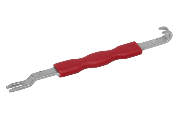

The red-handled double-ended job on the top isn't actually a trim tool, either.
It's an electrical connector separator tool.
9
90zcar
Nov 8, 2013
3,254
I remember buying that and it was labeled as a panel remover tool. It does look very similar to a connector seperator. I'll have to try using it as that sometime!! Haha

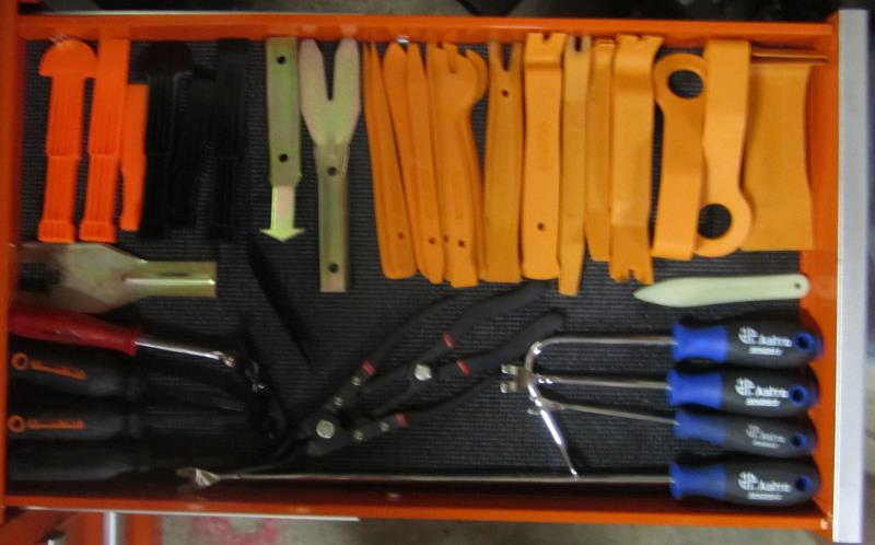

I have a mix of Blue-point and Snap on. But honestly... how do you guys know which tool to use? Blind luck, trial and error?
kythri
Jan 3, 2007
6,330
Lebanon, OR
For me, yeah, trial and error.
I pick whichever I think will be appropriate for the task, and then go to work - carefully.
If a particular tool isn't doing the job, I move on to another.
I'm sure there's probably a guide somewhere that I've missed. :D

ill have to post some pics of mine when i get a chance but i will say i picked up a 10 piece set from astro pneumatic for like 20 bucks on amazon and they have held up great look exactly like everyone else in the shop's matco or cornwell sets but mine came with 10 piece's on the cheep. Anyone looking to get a set i can't say enough good things about this one set i got http://www.amazon.com/dp/B005NMCE04/?tag=atomicindus08-20
kythri
Jan 3, 2007
6,330
Lebanon, OR
Those Astro Pneumatic tools are what are in my pic above.
Great stuff.
I've got two sets in there, as I've munged up a couple pieces by using them where I shouldn't have.
