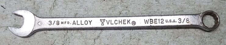

I found a Vlchek WBE12 3/8" combo yesterday. Notice that the ring of the box end is so thin. The chrome is perfect, so it was not thinned in the field. It's a long pattern, too. I wish I had found it when I was working on airplanes, as the thin box end would have made life much easier in some hard-to-reach places!
