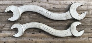

I was looking through the issues of Hardware Age that were recently uploaded to the International Tool Catalog Library, and in the August 8, 1940 issue I saw an ad for Vlchek tools. What struck me as odd though was that they listed aluminum plate as a finish option for wrenches. I looked on AA and nothing I saw mentioned aluminum plated wrenches, but maybe I missed it. Does anyone have any info on them?
30,921
Interesting. That's only the second time I have seen it. Note, though, that it doesn't technically say "aluminum plating", whereas the "bright plate" option is more explicitly a plating, and usually a reference in Vlchek publications lingo to chrome. The reference to "aluminum finish" could be some other kind of coating.
In the 1936 and 1941 catalogs, the available finish options for various Vlchek end wrenches were "Bright plated" (for their high end, again, ostensibly chrome), "Velco" (for their "cheaper, but equally serviceable" economy lines, and while I have never been able to find a TM or compositional description, almost certainly a reference to cadmium), sometimes more elaborately called "Velco Rust Proof" and "Velco White Rust Proof", "Natural" (self-explanatory), "Japanned", and "Black enamel."
Except for the 4-way rim wrench. That was available in "Velco Rust Proof Finish", "Aluminum Finish", "Black Japanned Finish", and "Natural Black Finish", and, note, in descending order of cost. Whatever the "aluminum" finish was, I don't think it was plating.
Lastly, whatever it was, it would've been banned during WWII. And it does not re-appear in 1949.

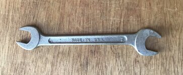

This 3/8 x 7/16 DOE is a curiosity to me.
Round head, Forged in U.S.A. , V symbol, 39 code and nothing on the reverse.
I’m wondering what era and set it may be from? TIA
16,660
Hi Humber,
AA has some information on the early Vlchek carbon steel wrenches here.
Here is a link to "Aluminized Steel" that explains how it was applied. It looks like an option for corrosion resistance that wasn't as expensive or as durable as chrome plating.
https://en.wikipedia.org/wiki/Aluminized_steel
