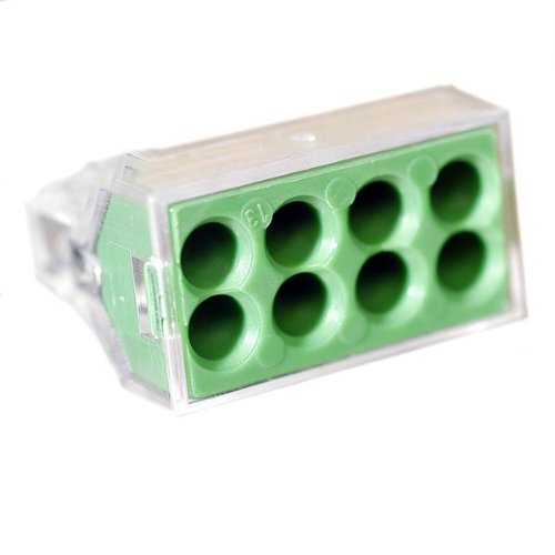

When multiple Romex wires go in and out of junction boxes what is the is essiest way to handle the ground wires?
I have been using a wire nut and pigtail when needed to sort this out. Is there a wire nut that can be used that could twist a few wires together and have one ground come out the tip of the wire nut? Is it acceptable to drill the tip out of a properly sized wire nut so that one ground could pass through?
I saw a copper looking crimp that solved this in one of my junction boxes. I assume this is readily available at Home Depot?
Thanks
yes, it's called a greenie. big box stores stock them
no, it violates the listing
yes, and you will need the crimp tool.
The copper ones from Buchanan require a spacial 4-way crimper. The steel ones from Ideal (and others) do not require any special crimper. A crimper for non-insulated terminals is all that's required.

The crimp does seem like it would be a pain to undo.
HD has 10 packs, and Lowe's has 50 packs. I just picked up a 50 pack a couple weeks ago. I've gone through about a third of them already, because none of the ground wires in my house have wire nuts at all...
Not all that bad, a good pair of dykes will cut off the splice cap leaving the wires intact, just a bit easier w/ copper then steel.

I have been an electrician for 35 years+. I am the only I have ever known who uses the Buchanon crimp tool with the Buchanon sleeves. I find the four jaw makes a far superior crimp to all the other options IMHO. They can be removed with diagonal pliers as was previously mentioned. Other than that they are there forever.
They are a great option on multi gang boxes where you need more than 1 tail for more than one device. Crimp all the wires, leave as many tails as needed and cut the rest off. Takes minimal space in the box also.

As mentioned in post#13 the Buchanan C 24 Press-Sure-Tool is the way to go, not cheap but makes a great crimp.

I have seen these crimps before, and always liked them as ground ties can sometimes be a real PITA. We use 4 pin crimps in aviation, and they work damn good.
It took a little bit of hunting to find the info, but finally I received my new Buchanan C24 crimper today. It is a crude version of the stuff we use in aviation, but just as effective. The guys that don't like crimps either don't use the proper tool, don't understand them, or have dealt with someone who didn't leave wires long enough for service work. The crimps are hands down far superior to any twisted on nut.
