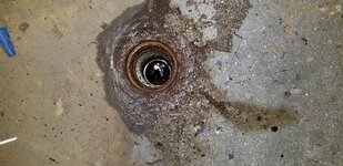

Update:
Got the floor bung off finally. Took some penetrating fluid, an 1,100ftlb cordless impact and some patience. No dipstick on the bung but the level is about 35" below the floor level and only approx. 6" deep. I have no idea where the fluid level is supposed to be or what amount of fluid it would take to get it there. Also, the appearance of the fluid doesn't look encouraging but I'm not sure what to expect it to look like after probably 50 years.
Unless anyone has any better ideas, I'll start trying to source several gallons of trans fluid when I get a chance.
I fully realize the outer casing might be rusted through. I figure I'll give the current plan a shot and hope for the best.

Do you hear air leaking when you have air applied to the tank?
It should be hydraulic oil not trans fluid.
I've made an effort to listen for leaks and can't hear anything. I don't have much air available but when I dump my charged one gallon compressor into the line it doesn't dump like there is a wide open leak somewhere, takes maybe 15 seconds to drop back to zero.
I've read elsewhere on the forum where people have used trans fluid in these lifts and that they can take use a fairly substantial amount. I don't know what the hydraulic oil would cost but I'm hoping to get some used trans fluid for nothing. With free fluid it seems worth a shot know if the lift is junk or not
F
Jan 10, 2020
15
backyard
If the tank rotted out and is leaking yes......................
So I guess the air could be going one of two places. Either through the case and into the ground or past the packing gland. I don't hear a leak past the gland. I'm thinking I could spray around the piston/plunger with soapy water and then apply air to see what happens. I had wondered if the packing gland could become dry due to lack of use.

The packing gland would have oil leaking out of it, providing it was leaking and there was oil in the system.
It's usually the top of the tanks that rot out if they are not sitting in ground water.

I'd at least stick an inspection camera into the tank to try and see what might be going on. I wouldn't pour gallons of transmission fluid into a hole in the ground hoping it isn't just going to leak out

If its been in the ground 50 years it probably has tanks/cylinders/pipes rusted through. Those are EPA required now to have double walls to prevent any ground water contamination. Yours is probably soaked the dirt under the lift with oil and would require extensive/expensive cleaning of the soil. You would be better off abandoning the tank/lift and don't let the government know about it.
