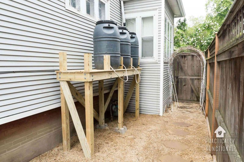

Can you use a smaller collection tank, maybe 30 gallons, and mount it on a platform 5 feet off the ground? Then just run a hose from the bottom of the collection tank to the larger tank. Can the larger tank be lowered a couple of feet so that the platform for the collection tank doesn't need to be so high?
If you decide to use a pump, do you want it to be automatic or do you want to turn it on and shut it off manually? In addition to submersible pumps (manual and automatic), there are also portable water transfer pumps (manual and automatic) which would work for your situation.

I like the idea of raising the 55 gal drum 4.5 to 5 feet and letting gravity do the work.
