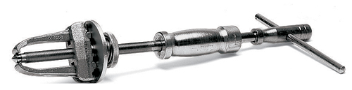

I have a couple, make up a lot of parts as needed but wated a heavy one a while back.
