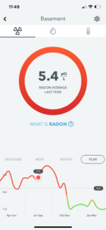

Unless I missed it, A good sign that your Radon mitigation company isn’t on the up and up is that they don’t have there own test equipment and they are relying on a customers air things meter. The ones that where accredited by the state and some agency had meters that where calibrated annually.
What kind of suction are you showing on the manometer?
I built a house about two years ago and between me and builder we overlooked installing Radon system during the construction phase. I bought a Airthings monitor and after the initial 7 day calibration period I had elevated levels 12+ on some days. I spoke to a couple in my area and decided to install my own system on my rural property. I researched it till I was blue in the face, bought the appropriate parts and made a hole in the unfinished part of the basement, my tile drain went to daylight so that wasn’t a viable option. I seen Immediate results and could probably get things better by sealing the basement floor where it meets the wall. If I put a lighter down there, the suction will pull the flame into the crack within 10’ of the suction pit location.
The Above Screen shots show the yearly average and big drop after the install in Sept along with the Monthly average of 1.3 coming out of winter which is generally the worst season for radon.
Congratulations of your success!
