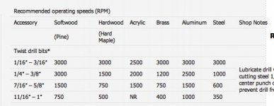

No one has mentioned the plastic grips missing. Would mounting the pillow blocks on the back side as designed have allowed them to be used?
Big difference of the two kits produced that's for sure.

I think running any drill bit 3/4 to 1" at 350rpm is nuts, even with a pilot hole to take away the thrust from trying to jam the center web thru solid material. Try 80-120rpm. There's no need to burn up your expensive edge tooling unless you have 5000 holes to drill. The drill bit will actually cut up nice curls at that rpm rather than just bouncing around a 6 sided hole.
The entire table posted above, used in mild 1018 steel or hot rolled A36 for that matter is a good way to buy or sharpen a lot more drill bits.

FYI, note your drill speed will vary depending on the material being drilled, the material of the drill (HSS / Carbide / etc) and the diameter of the cutter. The above chart 350 RPM is too fast for 1" in steel and way too slow for carbide.
