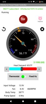

This is a picture of the app main control screen for my Afterburner controller from about an hour ago, you can change a ton of settings on other screens including 5 different temperature control schemes. As well as turning on auto tuning by elevation and a bunch of other handy stuff. It's a little homemade looking but has been rock solid for years, and I can monitor and control my heater from anywhere with a cell or internet connection. At this setting the air blasting out is about 180F and I can feel it across my shop.
