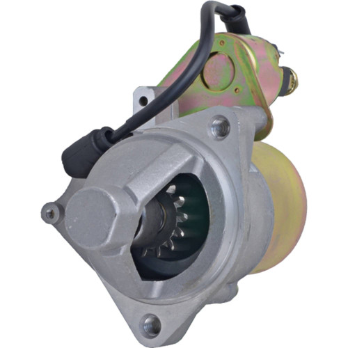

This Amazon link for the 338-459cc starter looks to have way to large of mounting bolt spacing:
This link for the 240-301cc starter looks close
I just do not want to pay alot for the starter and figure there has to be a more universal starter available for this PT1300EG engine

My experience with lower priced knock-off starters is that if DB electrical doesn't have it, you don't get it.
This is their version: https://www.dbelectrical.com/products/honda-starter-9-9hp-gx270-31200-zh9-003-128000-9400.html
I am basing that on looks not the description
Okay well maybe I'm wrong. Found this under ATV's.

Well lesson is, measure twice.......or five times
I don't think I zero'd the calipers when I measured before?
I checked the block and the old starter this morning
It's definitely closer to the 84mm of the 11hp-13hp starters online for a fraction of the cost of the OEM unit
Again this is for a 389cc 13hp engine
OccupantRJ
May 15, 2009
11,479
Eastern North Carolina
Get a measurement to the outside edges of the holes, then subtract one hole diameter, will be accurate. Alternately measure inside edges, then add one hole diameter.

A GX340/GX390 Starter Motor was a direct replacement, fit perfectly
It also cross references to the Predator, Generac, Duromax 389cc 420cc 439cc
petty much a universal starter for 11hp-13hp engines
