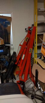

The usual, foldable leg 2ton engine hoist wouldn't take much more floor space than the one pictured, maybe 2ftx1ft ish but I haven't measured.
I hate giving up floor space too, but it's one thing I won't live without after having
