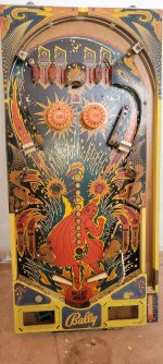

I also have a playing field and the scoring 'tombstone' glass from an old pinball machine which I always thought would be a good addition to the walls, but that has to get approval from SWMBO.
The story about how I acquired this is a good one. If you're familiar with the archaic 1950's/'60's term ****, then you may be of a certain age where you would recognize the name Al Goldstein, and the magazine he published, which was part of a US Supreme Court case involving *********** (Goldstein won his free-speech lawsuit). This pinball machine (intact and playable, but not w/o its problems in full-operation) came from his So. FL Intracoastal Waterway home, where he famously-displayed a set piece from a popular TV show, Spin City. Another very-public challenge to 'community standards,' 'public indecency,' and how one person's idea of 'art' can upset a So. FL city, and become a popular tourist attraction.
In an interesting development, what happened to his large sculpture remains a mystery, with roots in the aftermath of a So. FL hurricane.
