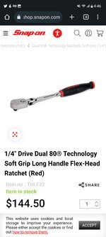

Why are some snap on 1/4 ratchets have the bolts going down through the top and some going up from the bottom?
I have several 1/4 and they are all going in through the bottom.
Thank you

The THLL ones have a slightly different mechanism. There's an additional retaining clip under the cover plate and the repair kits are different.

I remember screwhead on the bottom is less strong, so some updated versions moved to the top

Not true, exact same mechanism. Only diff in the kits are the screws. The screws going through the body are supposed to be stronger, but don't know why SO doesn't do it for all of them.

Right - I don't know why I thought there was a circlip. I must be remembering another ratchet; maybe the 3/8 fhllf. But, the 1/4 kits are different as you mentioned.

it is done for those with longer handle so that extra torque is possible in theory. they suppose people don't use cheater pipes.

Yes. There's also the argument of possible striped threads and if it did happen, you'd only need to replace the plate, but the SO screws are quite long and I don't see that happening.

You're more likely to bend the handle on a 1/4" than to cause any damage to the head.

My long handle 1/4 snappy ratchet on its third rebuild kit begs to differ. Handle is still straight as an arrow, even after 3 broken square drives.

I was referring to the plate design. I agree that the anvil is the weak point, but to say through screws make it a stronger design is moot. I'm saying you're more likely to bend the handle than to explode the ratchet head just because it didn't screw all the way through.
