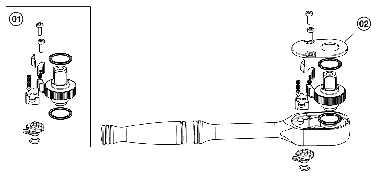

I’ll cut right to the chase, I have a Snap On FR80 with a broken indicator switch. When I say broken, the selector lever part snapped off (no pun intended). Truthfully it looks like it was made of pot metal. It was not purchased from a truck, nor do I have access. Looked at Snap On and it’s not available. I hope I don’t have a really expensive paper weight. And yes I have a pic to prove it.

There's a good chance that they'll warranty it but even if they don't the $10.50 P673297 rebuild kit includes the lever. The website clearly shows that.
I know they come with a selector, if they don't repair all your out is $10.50 and some time be back like new.

https://store.snapon.com/PARTS-3-8-Drive-Quick-Release-Ratchet-Repair-Kit-P673297.aspx
The diagram shows that the kit includes the lever.

If the lever is really unavailable they will send you a brand new replacement that they consider equivalent. Either way, if you don’t contact them, well, you are just trolling.

You have a Snap-on tool. Your tool has a lifetime warranty. Assuming you're the original purchaser, and therefore, your warranty is valid, the ratchet is still produced, and there's repair kits still available.
I think that's the reason why there's comments poking fun at you - call for warranty service. Don't worry that the single part you want isn't in stock. Just call, and let them handle it how they choose to handle it.

I just wanted to say that's a real cool drawing they got of the FR80. :)
And if you click on it, it gets super big. :)
