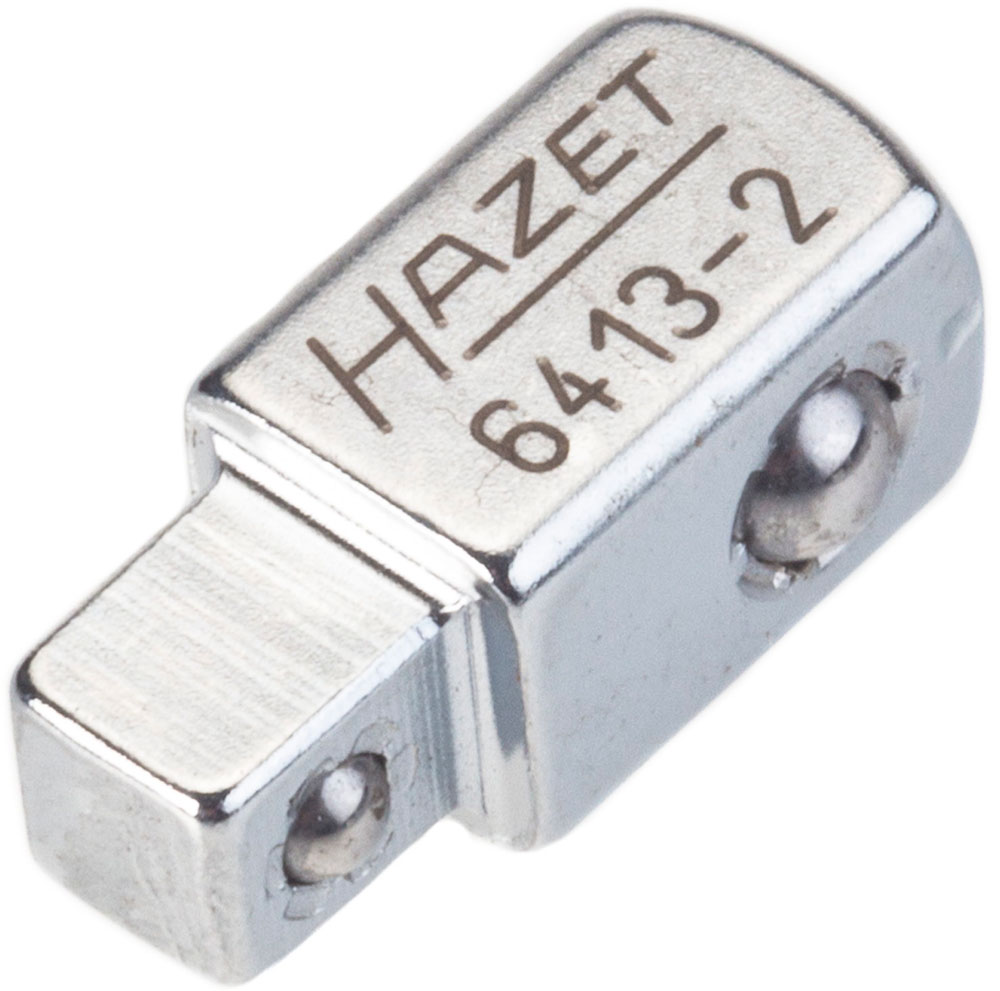

What about using an adaptor?
This one from Hazet (6413-2) will fit the 1/4 female and give you a 3/8 drive.
$10.57 from chadstoolbox.com
$16.80 from samstagsales.com (scroll all the way to the end of the page)
tools-from-germany.com (for reference)
