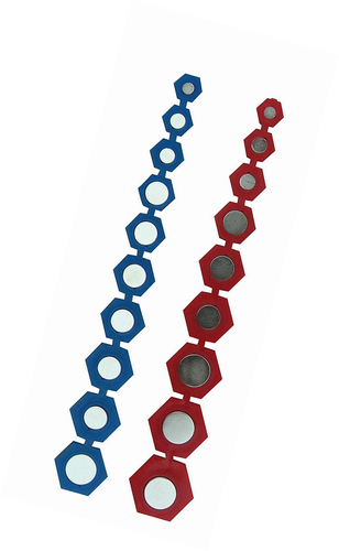

Found this today at my aunts place, looks vintage.Anyone used this before?

I've a set of both. Put them in all my shallow sockets for a while. One by one I poked them back out again to regain the missing depth needed for full contact on very tight fasteners. They work and are sort of handy like twice a year but just take up too much room inside the socket. I need full contact in a socket a whole heck of a lot more than I need the magnet.

I bought a set a few weeks ago after I did the EGR valve on the Jeep and was cautioned to not lose the bolts (and it was a completely blind 3 bolt removal/replacement in the back of the engine procedure)...so I figured I'd get them for the $10 bucks or so for both sets...hopefully they come in handy...but we'll see.
I too had concerns about encroachment on available depth...if I remember...I'll post back after I give them a trial run

Probably something that will end up in my toolbox and forgotten about

Those would have been awesome for an ecotec water pump. Dropped a bolt into a crevice above the oil pan but it took forever to figure out where it went and pulled the oil pan to

I purchased a set a few years back as I thought it was a great idea. Well, they are still in the package so.......

I bought a set 20 years ago. The one I used fell out of the socket. No idea where any of the rest of them went anymore.

I got a set a dozen years ago. Still hanging unopened on the pegboard.

Just did a 2004 Jeep Liberty radiator today. Used tape on the socket to put a bolt in on the passenger's side for the power steering cooler. It's a PITA place to get to and can't get to the bolt to turn it by hand.
This would have been cool but if I don't need it again in another month or so I don't need it. Tape on one bolt every month is cheaper than another gadget.

I’ve had sets of those in use for years... great little tool, I have them set up in my 3/8 shallow chrome in metric and sae. They get used pretty often and I have 3/8 impacts when I needs a socket without the interference. So no switching in the moment...
Occasionally I do have the clean out the magnet. All in all they’ve been very handy for certain jobs.

I have them and use them once in a while. I don't have too much of a problem on Depth, as I do having the magnet come out of the socket and stay on the bolt/nut.
I have switched over to using gray pneumatic's magnetic sockets. Love them. I ignore all my snap-on and others for these:
