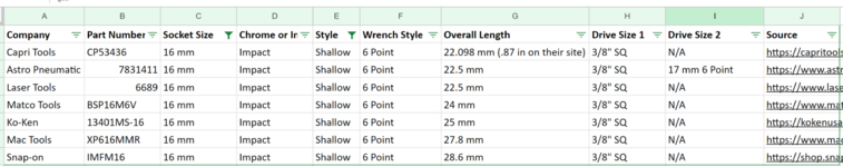

I am trying to create a database, that will allow people to sort information on the various sockets from different manufacturers, to determine which sockets are best for their application. As of right now I'm just starting with length. So far I've added about 120 rows.
This is an example of what I got so far, sorting by 3/8 6 point shallow impact. I was surprised to find out that Capri Tools seems to have the shallowest sockets based on this sorting and for the sets I have gone through. They are very affordable.

For the source column, I'm trying to list the official website from the company where the data is found. But sometimes that is not is always possible. For some sets, it seems the length of the individual sockets is not listed online, and someone will have to manually measure and update the spreadsheet, for which I suppose we can put "measured by so and so" as the Source.
This should be a neat community project, and I'm interested in seeing where this goes and how it expands. Please update the spreadsheet with information that is missing, for sets I haven't gone through, and haven't added. Just add another row.
This is a Google Spreadsheet.
If the individual sockets don't have a part number, we might just have to put the part number or SKU of the set they come in.

I would like to expand the spreadsheet to also include universal/swivel sockets. So that when a standard socket won't fit, you can switch over to a universal/swivel, and know which one is the shallowest. But there would defiantly be some other dimensions involved in this consideration. I think it's good to not only see who has the shallowest sockets, or possibly even the least wide (something we can add in). It can also be helpful, if say I already have shallow and deep and in the market for a mid length/semi-deep, I can look through the list for sockets that are closest to right in the middle in terms of length between my shallow and deep sets I already own.
I just added in those cheap Neiko sockets. Is there a good way to manually measure broach? The "shelf" where the fastener bottoms out on some of the sockets I have is often slanted downwards, so you can get different measurements depending on how far towards the center of the socket you go, but I'd imagine the measurement closest to the edge of the walls should be used.
@AEAdam could please you add the Snap On sockets your referring to, to the database? I'm not sure which ones those are. The one's I find seem to be larger then the Zeal. I liked those pictures by the way in the thread you linked.

Pretty impressive collection. Looks like your got a pretty complete set. It is probably overkill, creating this database. We got about 430 different sockets so far, and hopefully we can expand it to include a lot more, and others can add to it.
Here's what I've gathered so far.
1/4" 6 Point Chrome Shallow Standard
If you want to use a normal (non-pass through ratchet or wrench), Ko-Ken is the shallowest.
If you want to use a box end ratcheting wrench, Boxo is the shallowest
1/4" 6 Point Chrome Shallow Universal
The shortest overall profile for common sizes (10 mm, 12 mm, 14 mm) is Mac Tools, followed by Matco. There is some variation in the smaller sizes.
3/8" 6 Point Impact Shallow Standard
Franklin and Capril Tools are both the shallowest
Y
YoshiMoshi3
Nov 2, 2022
494
If everybody could please contribute some data, that would be greatly appreciated!
We are now at 734 different sockets. Based on the sockets analyzed so far:
3/8" 6 Point Chrome Shallow Standard
10 mm-14 mm - Snap-On is the shallowest
15mm-19mm Boxo is the shallowest
3/8" 6 Point Chrome Shall Universal
10 mm, 12 mm-14 mm - Nepros is the shallowest
11 mm, 15 mm-19 mm - Matco is the shallowest
