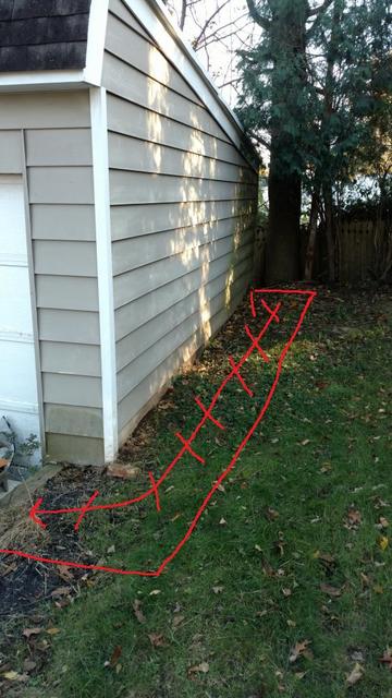

I have a ton of work to do on the house which outranks finishing the garage, but I need the garage to be functional in the winter to complete projects for the house. Before I can even think about insulating the walls I need to figure out how to get the soil below the siding.
I tried digging a few inches thinking it was just up against the lowest siding panel but soon realized there is another buried beneath. I would have to remove soil from the entire yard. Adding another row of cinderblock on top of the foundation is an option but labor intensive and expensive. I'm not sure if digging and filling with gravel for drainage is an option, but it would mean even more stones to shoot with the mower.
What is my best option here?

You have a big project there. You will definitely want to trench around the foundation to figure out how deep do you need to excavate. You will need to grade the lot away from the structure, or else rain and runoff will continue to head towards the building.
Like I said it's a bit of a job. You may need to put in some kind of French drain with underground pipes etc.
On the other hand, if you do it right you won't have to do it over.

Ideally, the soil should be max height at the height of the driveway/slab, and then slope down from there, so that concrete would be holding the wood up higher. I'm going to guess a detail in the elevation was mistaken, concrete poured and the decision was to cover up the mistake.
Adding another row of block would solve part of the issue in my opinion but introduce a leak path that could cause water to leak between or under the block and down onto the lower concrete floor.
The only bullet proof solution imo is to regrade everything to the spec above.

That fix will be a regrade of your entire lot. That soil level has to be much lower and you won't know that until you dig it out for reference. The rest of the lot as to be lower than it. You're looking at using at least a skid steer. Perhaps in addition to the grade work, add a french drain to help.

Easiest solution;
Dig down below the siding and remove siding, replace any rot with PT wood, then use peel and stick roofing membrane sealed to the foundation and up enough to be higher than ground level. Replace siding.
Lots of houses have below grade PT foundations, this wouldn't be much different.
Edit; Reusing the siding only applies if it is vinyl or maybe concrete board.

From looking at the first picture, it appears the garage is really close to what looks like a fence in the back. If that is the case, then grading the back side of the garage could pose a problem for you.
Basically you need to remove the dirt from around the garage, which means that area will be lower and the water will want to collect right there. So as has been said, you need to grade the entire yard so that water is directed away from the garage. You can do a French Drain system but it would still be of great benefit to grade the entire yard.
The only other option would be to raise the garage and pour a short concrete wall (or concrete block wall) then sit the garage back down on the wall. Problem is, that isn't going to be cheap either so I think the most practical approach is to remove the dirt around the garage and grade the entire lot. If you happen to know someone with a Bobcat they could do this for you and probably not charge you an arm and a leg.

Not the whole yard needed. Dig back five feet and make a two foot retaining wall to hold back the yard. In the five feet or so dig and put in a French drain and drywall if behind you is not able to accept the water

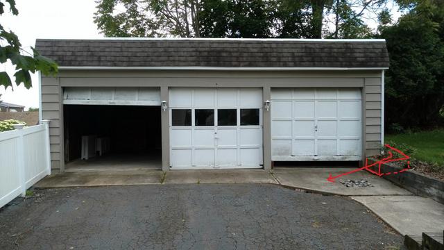

The lot I'm on is only about 50' wide on a fairly steep hill and the garage is tucked right in the back corner. The neighbor's property drops 18" to my yard, the yard drops 18" to the driveway and then the driveway drops 36" to the adjacent lot.
Running some quick numbers it seems that any proper regrade effort would be ~10% of the entire property/garage/home value due to all of the retaining wall work involved.
A french drain or small wall right next to the garage may work as I could drain right into the driveway which runs down to the street.
Right now I have no issues with water in the garage (except for a roof issue) so I'm just concerned with the moisture near the bottom causing rot or mold issues if I ever wanted to insulate. Would it be a viable option to dig out and remove siding until above grade, build a form and pour concrete right around existing sill plate and studs, then set up temporary support so I can trim the studs and install a new sill plate?
I'll probably be here for ~5 years and don't plan on completely finishing the garage, just trying to see if I can preserve the stucture and potentially make it more comfortable for winter

So, the garage floor is above any adjacent dirt level ?
So, there is no garage wood framing below the dirt elevation on any side anywhere ?
You showed a dark inside wood wall, but it just looks funny, not like water wetness damage.

The soil level on the right side of the garage is 12-18" above the garage floor. The right wall was framed on 12" of concrete presumably to account for the higher grade, but it's not quite enough. The left side of the garage where the grade is well below garage floor level the wall is framed right at floor level.

You do have a problem with water in the garage. I can see it in the second pic. Just because you dont have pools of water does not mean an issue dosnt exist. That pic of the back side of the wall is going to be the best looking place once you dig out the dirt from the wall.
If it was me and i wanted to do it as cheap as possible i would dig down and make a small swale then pack gravel in but not as high as the top foundation block.
You could always shore up that wall from the inside, cut a 16in section of the wall out above the block. Add 2 more layers of concrete block, fill the block and lower the wall back onto it. Sounds like alot of work and it will be but once its done..its done and you dont loose any yard space

After seeing pics definitely a block retaining wall a few feet back. Use landscape blocks. Dig down to bottom of slab level then trench down a whole block height so it’s buried. Had the same thing on my house where the hill was going right to the house. Rented a bobcat and made a patio with four foot walls. Not rocket science just a lot of heavy lifting.
