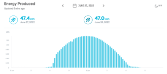

I have IQ7A micros. 405W REC Alpha panels, all flush mounted. I haven't seen any clipping on the curves yet, maybe next month? probably not due to the angle. I see 5.6kW output peak on a sunny day. hitting 3kW+ by 0730.
probably something like sensorless vector on a VFD. that is also magic.
What do you mean by flush mounted?
