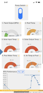

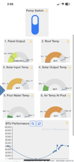

Alright, time for a little followup to the solar panel installation.
I've had it running a little over 2 weeks now. There was a little trial and error to get the pool pump set in a way that it was happy. I think we're at 40gpm at the moment. That seems to be a reasonable compromise between filtering capacity, heat input, and system pressure. Popped off a coupler, blew off the hose to the pool vacuum in the process, but seems to have settled down. One thing I've haven't figured out where the system is sucking in some air, maybe the air bleeder valve.
The system seems to be adding about 5 degrees to roughly 15,000 gal during the day. An example from last week, the water temp started at 85.5 when the system kicked on at 1000, and 90.7 at 5:30 when it kicked off. I have a thermometer on the pool water coming in and going out of the solar array and I seem to see a 4-5 degree temp delta while running. Its interesting to see how much heat is lost during the night with no cover. Right before I finished the system, the pool temp was hovering around 80-82 degrees.
So, what have I learned? More panels would be better. Not for more heat, but just more volume to filter. Its a little challenging to determine if the pool is a little dirtier because the through put of the filter is less, or maybe its been a little windier or the bush near the pool is shedding spent flowers. If I was starting from scratch and putting a pool in, might plump for the solar heaters to have their own circuit to completely seperate it from pool cleaning. Also, setting the system up by myself on a cement tile roof was a little tricky. Once the pool season is over, I might sacrifice a few dollars in piping and get some help to try and set the system up neater on the roof.

Yep, double the panel count and 40 GPM will be right on target for flow :) For now, you can just set your bypass valve so that not all flow goes to the panels? I think you'll want about 16-20 GPM for four panels.
The vacuum breaker valve, you'll want on the high pressure (supply side) as it will for sure allow air in if on the return side. Mine needed to be at the beginning of the panels (so sees higher pressure) to remain closed during solar operation...otherwise it did let air into the system. That setup (vacuum breaker on the supply side) seems typical as gravity on the return generates negative pressure. If the negative pressure on return side of the panels opens the vacuum breaker, then the pump too has to do a lot more work (and flow will drop off a lot) as it is not getting any help from gravity on return.

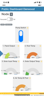

Two warm days and the pool picked up 20F, from 66F to 76F. That’s 1.2 million BTU…crazy. It’s pretty much fully shaded so all of that is from the rooftop solar.
I’ll have to pop some sensors up in the attic to see how much the rooftop “cooling” impacts attic temperature and therefore AC load on the house.
