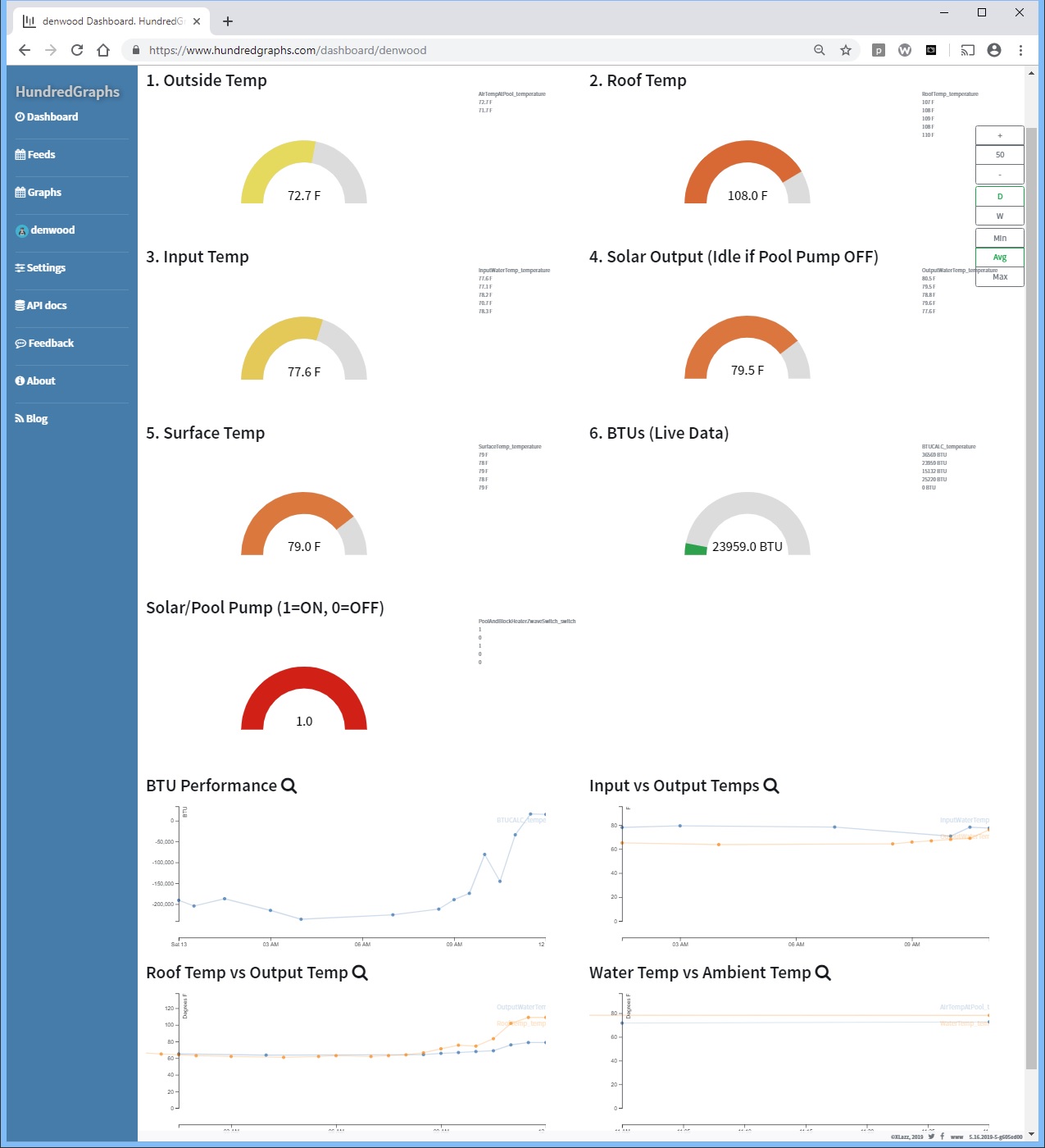

Hundredgraphs does a nice job of graphing the inputs, as well as a free real time dashboard to check in on things.

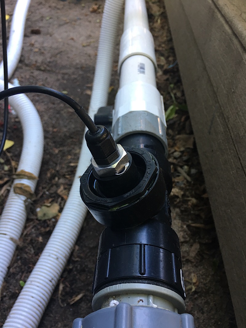

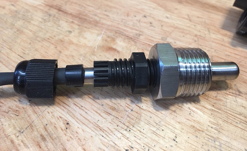

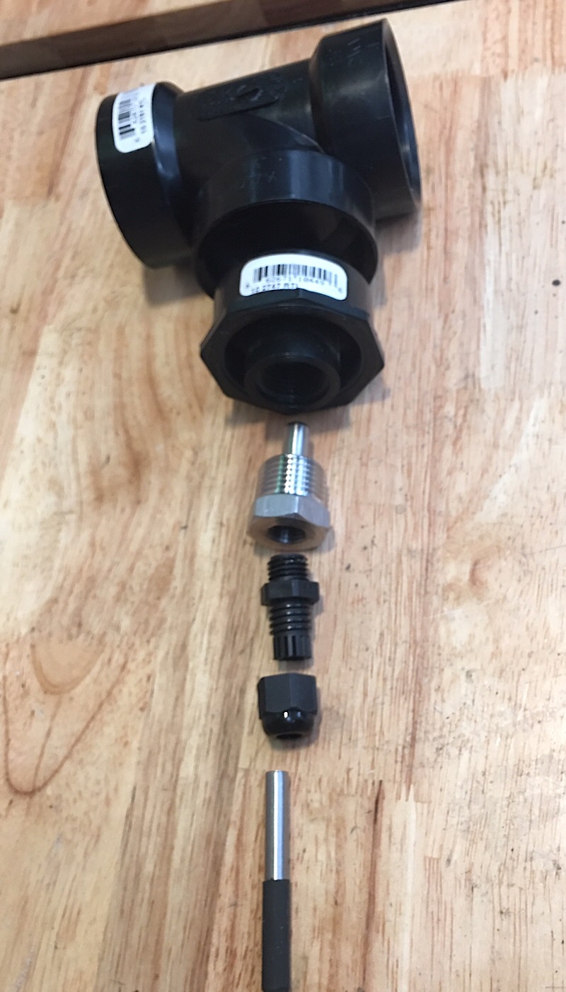

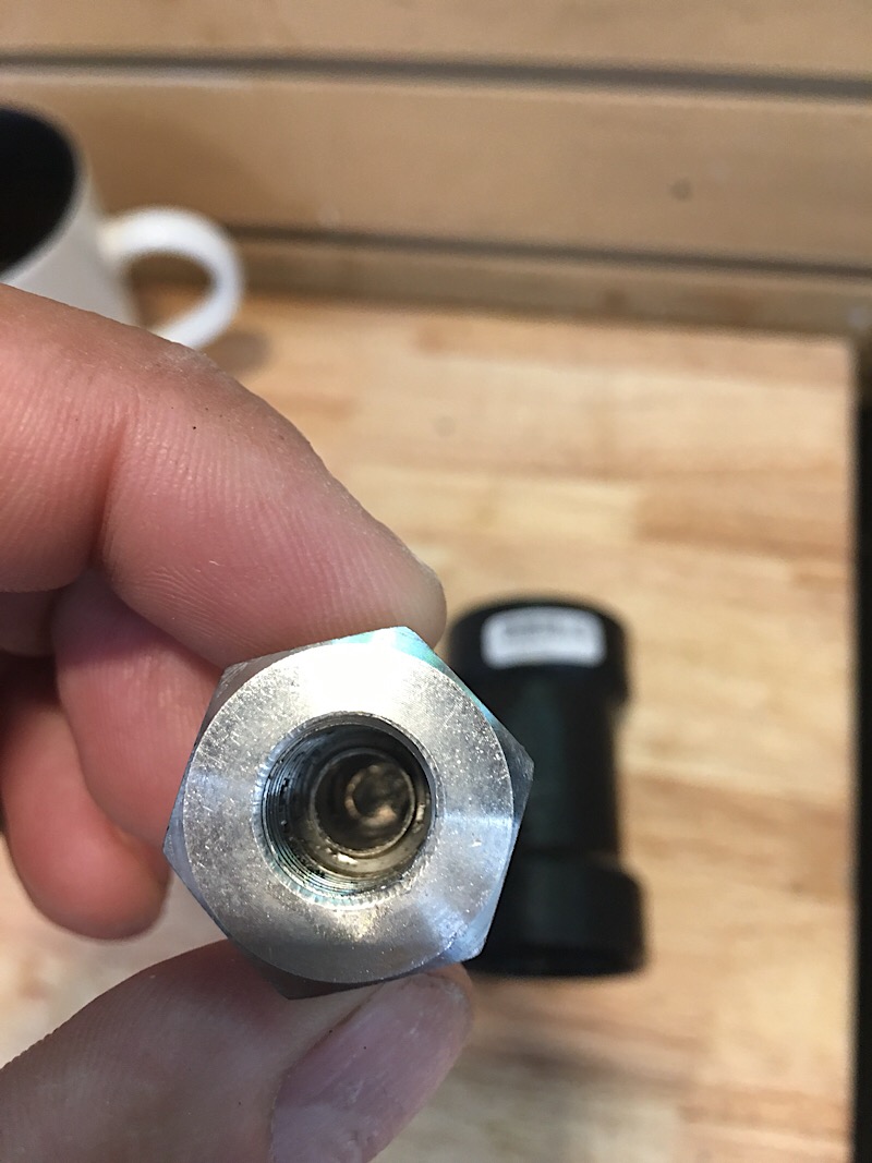

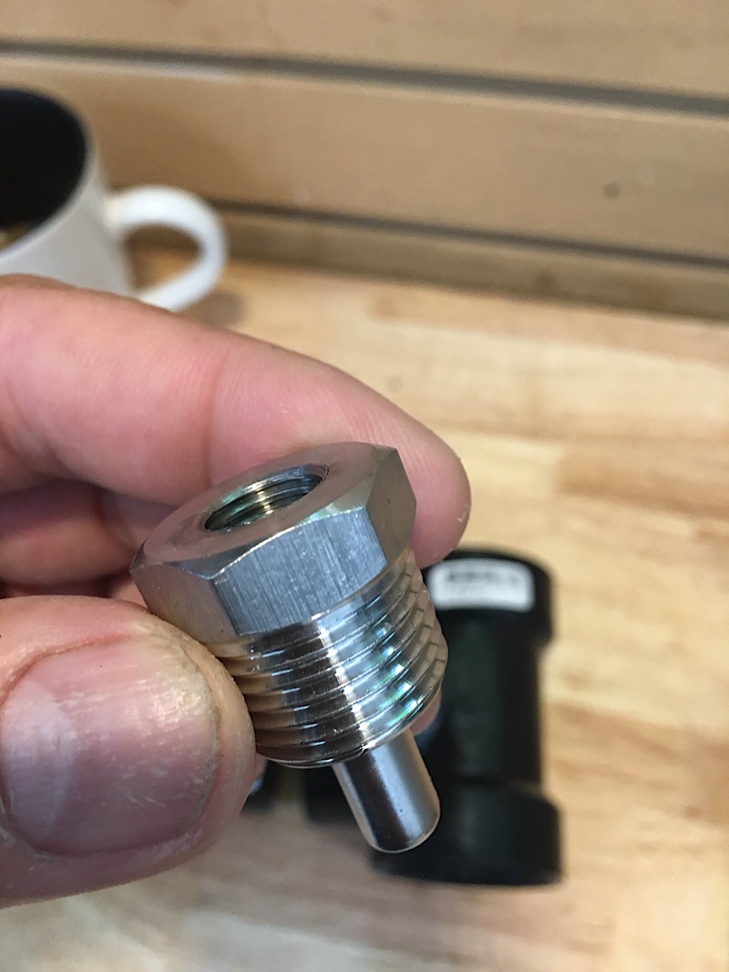

I was looking for a more accurate way to get fluid temps with a solution that protects the probes, does not cause a leak hazard, and is easily removable. Enter a solution from the world of beer brewing (and likely every lab worldwide...ha), the thermal well. The pics are self explanatory.
The very inexpensive (but quite accurate) DS18B20 waterproof external temperature probes I'm using are available all over amazon etc. They have a diameter of 6mm. It turns out that these thermal wells are designed for them :) I was unaware that a "thermal well" was a thing a week ago, so was very interested in checking them out.
I used a 1 1/2" ABS T, and a 1 1/2" bushing with 1/2" thread to plumb in the thermal well:
The thermal well ships with an insert, seal and top nut for a watertight installation:
Here it is installed:
Water temps ranging from 78 to 82 make for some successful backyard parties!

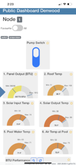

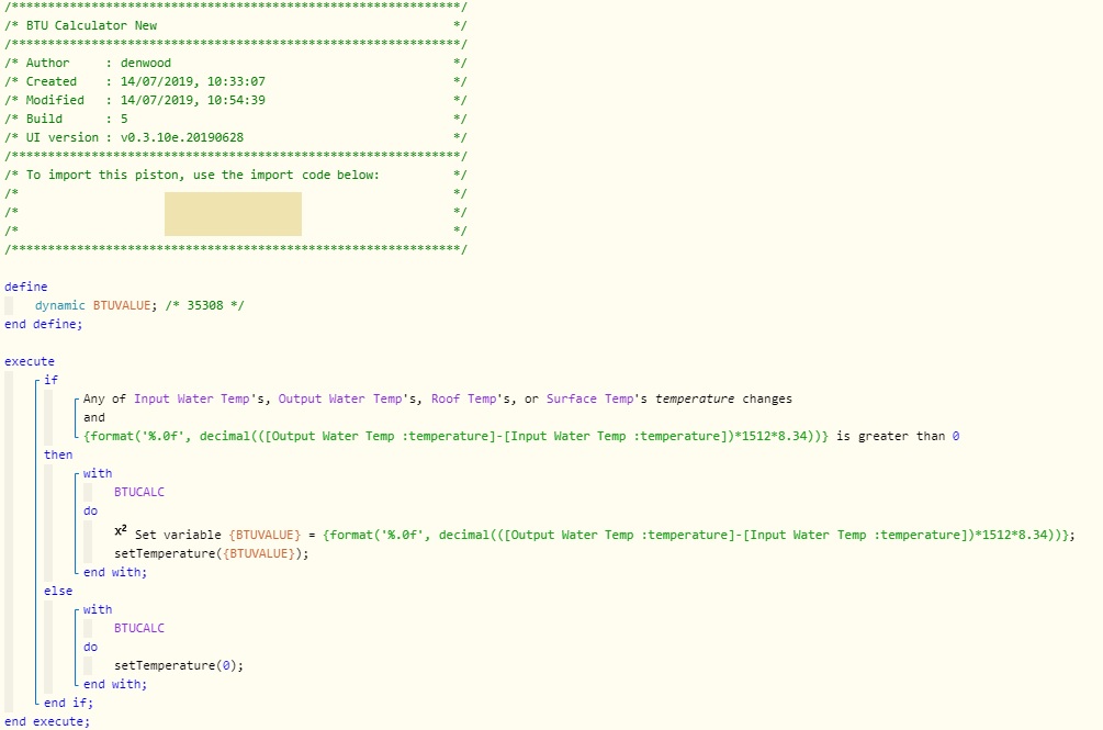

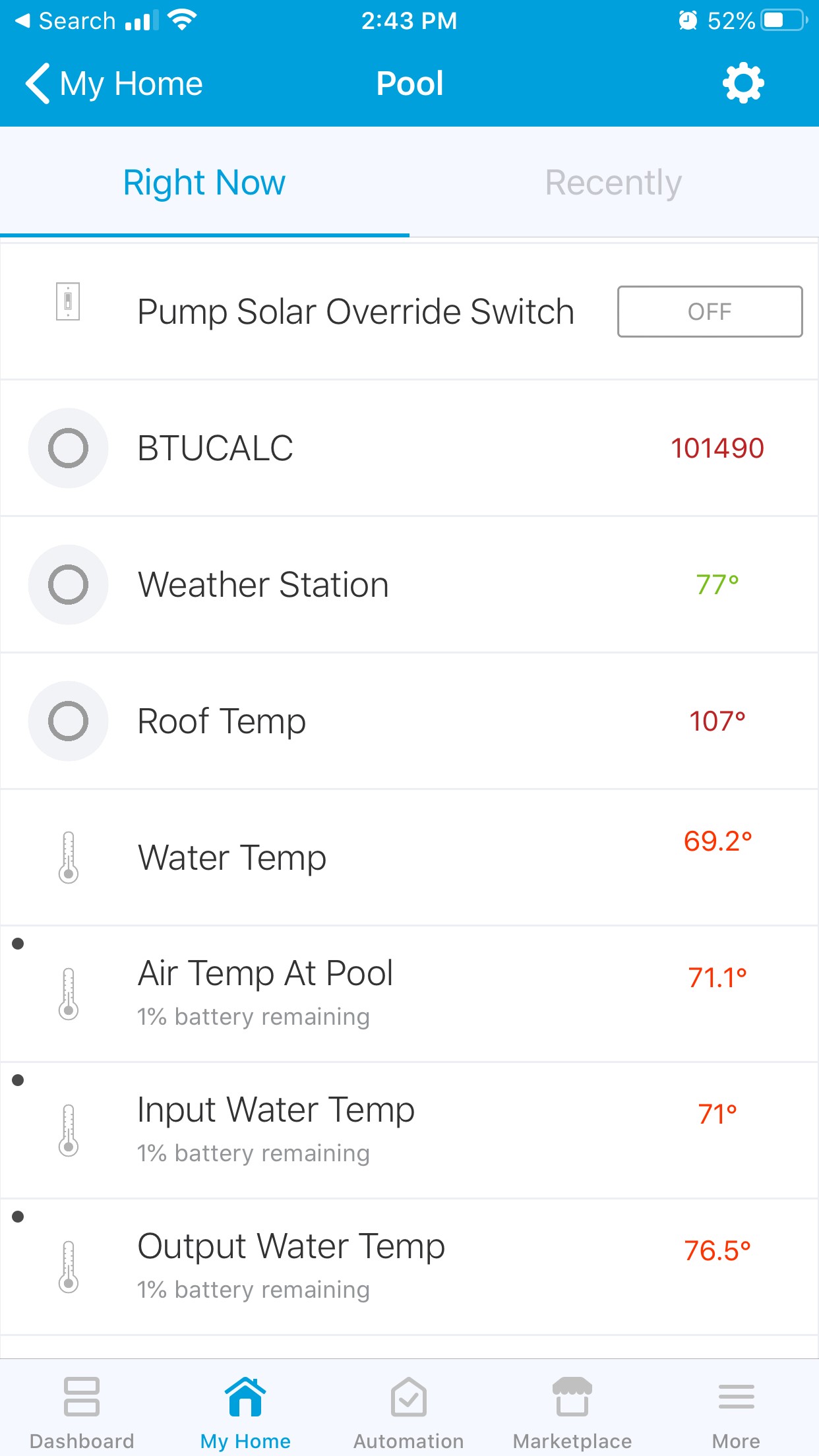

Here's the updated dashboard with "live" BTU calculations. Serious geek stuff here (click to visit the page). To calculate live BTU output, I created a simulated temperature sensor in SmartThings, but feed it a value calculated using the difference between input, output, and the measured output (GPH) of the system on solar. This in turn is spit out to hundredgraphs to display BTU output "live":
and just in case someone down the line is looking to recreate the live BTU calculation, here's the code:

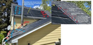

I had one leak on the roof to address where water had sat in a previous panel repair. If you seal off any of the water channels (to repair a panel leak), you really need to do it at both ends of the panel. Water trapped in an isolated heat channel cannot drain and in this case froze over winter. It just took a few minutes with a soldering iron set to 700F to heat weld and repair the panel. I reduced the feed piping / connections a lot by modifying my four original panels for full parallel flow. Each intake had a restrictor 12 inches inside the intake pipe side of the panel. I just knocked that piece out which in turn allowed me to simplify the plumbing feeding those four panels. This in turn should provide better flow through the lower four of my eight 2x20ft collectors and again bump array efficiency.
If you are running panels on different parts of your roof, this is all you need to know about plumbing. You need to make sure all returns go the highest part of your system which in my case meant adding some pipe to the lower roof array to bring the return water all the way up to the upper roof array return...basically 1 story up. If you don't do this, the system will not flow properly...the upper array will see zero flow.
Not my roof but an example from the article link above:

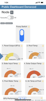

Here is a pile of 2022 data that should help the next guy put together an efficient and high performing system.
I've simplified the pool plumbing to the first four panels by removing the internal flow restrictions in each of the intake tubes on the four lower collectors, and removed basically a plumbed in manifold. The end result is much better flow to the lower four collectors which drape over the lower roof. We also set a new record last week raising the pool temperature 10 F in 1 day. That's 583K BTU in to raise 7000 US gallons by 10 F.
I have two pumps running in series (Intex OEM pump + 2 speed 1HP pool pump) to provide enough flow/pressure to supply the panel array/filter and ran a few tests of flow with the new plumbing setup into the current setup of 8 2’x20’ panels, 320 sq/ft.
Low Speed, both pumps 17.5s 5 US gallons (with solar) using 5.3 amps@120V :
1028 GPH total
= 17.14 GPM total
= 2.14 GPM/panel
High speed both pumps 10.5 seconds for 5 US gallons (with solar) at 11.4 amps@120V :
1714 GPH total
= 28.51 GPM total
= 3.57 GPM/panel
If you research ideal flow for this type of solar collector, most sources report 4 GPM (gallons per minute), per 40 sq/ft panel (0.1 GPM per sq/ft) is the most efficient balance between power use on the pumps, and energy gathering from the panels. I ran some tests on a sun/cloud type day, with air temps at about 72 F, around 2pm.
At 2.14 GPM/panel, the best we did was 75K BTU, with a 10 F difference between input/output temps.
At 3.57 GPM, output jumped to 100K BTU, although temperature rise (input vs output) dropped, as you'd expect with higher flow, to about 7F. This pretty much demonstrates the fact that you don't want high temps in the panels, as they lose a lot of efficiency when you exceed ambient temps (the panels start losing heat to radiation).
So the good news is the panels now output over 100K BTU, and we have yet to see a day with temps over 74 F. The theoretical max for this setup (capturing 100% of the sun's energy) is 136K BTU. I expect we will see 110 BTU on the system, which would work out to about 80% efficiency. Not bad at all!
The next tweak will be to try two Intex pumps in series to lower the power use of the pump combination. I've found that the Intex (pump that came with the pool) uses only 1.4 amps and is rated at 1600 GPH. I've tested it in the current system (solar panels off, but flowing through the sand filter) using 1.4 amps, but flowing 1200 GPH. Meanwhile the 2 speed pump is running at 4 amps at low speed, but only moving 750 GPH. I've ordered another Intex pump which I pieced together from the Intex site (replacement parts) which is rated at 2100 GPH (1600 when connected to filter) and uses 2.1 amps. The Intex pumps move a lot more water with far less power use than the 2 speed pool pump, so my hope is that we'll get down to 3.5 amps (vs 11.4 amps) of power use while moving close to 4 GPM for each panel.
These two parts will get you a working 2022 Intex pump rated at 2100 GPM:
https://intexcorp.com/uncategorized...r-12in-sand-filter-pump-26645-org-sp-12491eg/ ($ 105 USD)
https://intexcorp.com/replacement-p...mp/11826-pre-filter-assembly-for-28645-28646/ ($19)
Those bits get you a working pump for $125. If this experiment works, we should have the correct flow, but with power use more in line with a $1500 variable speed pool pump using two inexpensive Intex pumps in series.
Here is a snapshot of data from June 10, 2022 from https://www.hundredgraphs.com/public/denwood

The current panel setup:
Taken around 11 am so you can see just how shaded this pool is...

That said, I’ve done some more efficiency measurements with our solar array and found input as high as 119K BTU (or 35 kW) around 2:30 pm on one of our warmer (29C) days. The theoretical max for the system (given 320 sq/ft) at 100% efficiency is about 144K BTU, or 41 kW of heat energy. This means that on a warm day, the system is at 82% efficiency. This is far and above the 22.5% of a good EV panel in 2022....however heat pumps have a much higher COP (around 6) when it comes to watts used in electricity vs watts added to the pool with respect to heat. It's interesting in that the COP of a heat pump allows you to generate ~ 30kW of heat energy from about 5kW of electricity.
Tuesday June 7, the system recorded a 10 degree rise in water temp for a total of, 583K BTU added to the 7000 gallons of water. It looks like 100K BTU is where the system is averaging for a cooler, sunny day between 11:30am and 3:30 pm

I've been bugged a bit by how much power the solar pool system eats up with the 2 speed (10 amp@120V) pump in series with the OEM Intex pump (about 2 amps) and the 12" sand filter. That got us to about 1714 GPH (or 3.57 GPM per solar pool heating panel). I was intrigued by how little power the Intex 2100 GPH SF-80110-1 pump consumed and wondered if just putting two in series would get me similar flow, but with far less power use. Power use ramps up quite a bit with flow, and it's not a linear relationship.
Anyway, I ordered up a new pump from Intex using their replacement parts site:
The above two parts gets you a working pump 2100 GPH pump (SF-80110-2) for about $124. These newer Intex pumps have a digital timer and can also be set for continuous operation. More importantly the GFCI plug and pump will revert to a powered state after power is cut to them...in my case by my Zwave outdoor plug. This has not been the case for some of their older products, which was a real PITA to work around. The first unit arrived DOA, however Intex replaced it with no issues or cost to me.
I also ordered up a 21" Hayward sand filter to reduce system pressure. This is quite a bit larger than the 12" sand filter, (.7 sq/t filter surface) with a lot more filter surface area (about 2.7 sq/ft)...so it offers up less resistance than a smaller unit.
I won't post up all my test results, but here is the skinny.
The previous setup using a 2 speed pool pump (10amps@120V on high speed), in series with the Intex SF 80110-1 pump, (2 amps@120V) and 12" sand filter flowed a decent 1714 GPH through the system with solar panels in the loop. This works out to 3.57 GPM to each of the eight panels. It used about 12.8 amps (about 1500 watts) with the salt water chlorinator on.
The new setup has one Intex pump before the 21" Hayward sand filter, and the 2nd Intex pump after the sand filter. They are plumbed essentially in series. Flow is now 1765 GPH, or 3.67 GPM per each of the eight solar panels. The big difference is that the system only uses 4.32 amps (about 494 watts) or 3.72 amps after the chlorinator completes it's 2 hour daily cycle. For anyone counting, that's 67% less power use during peak power rates in the afternoon! I also found an amazon sourced "intex" hose in the mix that was only 1" ID. The correct Intex hoses are 1.5" ID, so pulling that out of the mix, did make a small difference too. In any case, I'm pretty happy that we're close to the ideal flow rate/solar panel of 4 GPM, but with power use reduced 67%. Coolio!
At this flow rate, the pool is fully filtered (with solar panels in the loop) every four hours. On an average day, the system runs for 7-8 hours, so we're in good shape to keep the water clean and warm too :)
I would summarize the "hot tips" as follows:
1. Make sure all of your hoses and plumbing are 1.5" ID.
2. Use a larger sand filter. I bought a 21", but I suspect a 16" unit would have been fine too for my situation with a 7000 gallon pool.
3. If using two pumps in series as I am, plumb one in before the sand filter, and the other after it. This made a substantial difference in system flow.
4. Use the Game Intex 40mm to 1.5" plumbing adapters (for running hard pipe), and order 1.5" Intex hoses directly from Intex's site...they are much cheaper to buy this way.
Here's the latest setup:
System power use with the chlorinator off:
And with chlorinator on:
The current system is working extremely well, peaking over 100K BTU.
