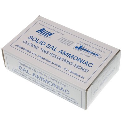

There are a couple other "must haves" regardless of the iron you use:
1. Sal Ammoniac block to clean a black oxidized tip that no longer transfer heat efficiently. (don't use abrasives!!)
2. Tip Tinner. Efficiently tins tips to like new condition.
When you turn the iron off, coat the tip with solder as a barrier to oxidation.
