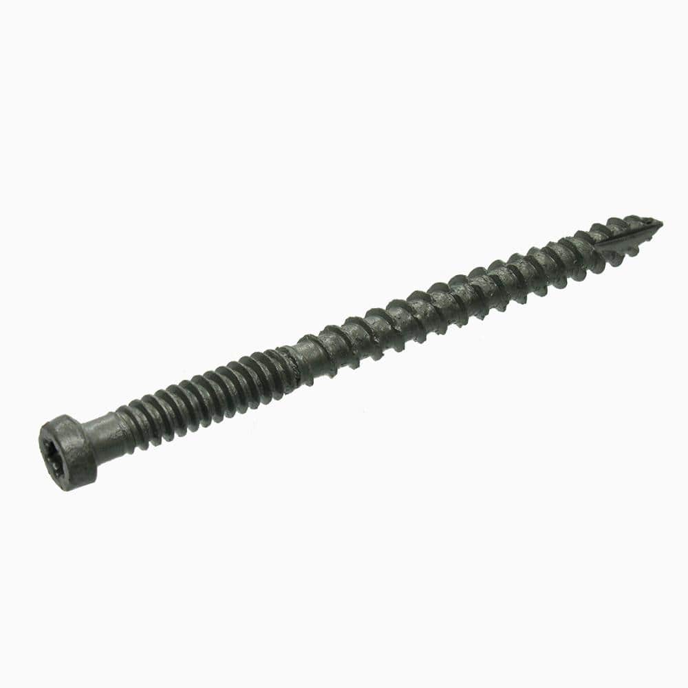

Have a composite deck (trex) that was done in 2004. This was before the planks had side slots for hold downs and the screws were put through the face. The installers spaced the board out very little so roof shingle granules and other small bits of stuff plug up the gaps between boards and water collects when it rains. I can't even get a putty knife between them in some places. So I am taking up every other board and narrowing it a bit. I thought about just spacing out the boards a bit more but then the holes for railings wouldn't work out. Running them through the table saw and routing a slight bevel on the edge is working well. That's just background...
The screws used don't seem to be available any more and I figure it would be good to replace them. And a few stripped out so I would like to use a slightly longer screw (originals were 2.5"). The planking is gray. The only thing I have found that is close to matching is just an exterior screw similar to a drywall screw but galvanized. Those should work but wondering if better ones are available. The pic is the original screws.
Where the planks parallel the side of the building the plank overlaps the ledger board and the flashing above it which traps moisture. Wondering how this is usually dealt with. My plan is to cut a bevel on the bottom of the edge so the plank runs to near the siding but is thinner leaving some room underneath.
The picture of the stairs is not at my place - it is an example of the fascia material I would like to get. I have seen some 1/2" material used on more recent decks. What are the brands used there? Also have seen screws that look to have heads similar to button head cap screws as the counter bore looks straight sided but they might be angled for more conventional countersink . Who make them? They are color matched to the 1/2" material. It was black but I am looking for white. Vinyl J channel was used on ours but doesn't seem to even be made any more. It also rippled in spots.Facia.jpgDeck screw.jpg

Those are standard composite decking screws that you can buy at just about any home improvement store. You may have to order them to get the right color though. When those screws come out they blow out the top of the composite decking, because the upper threads are cut in a reverse pattern to prevent them from coming loose over time. Don't use an impact driver on these to remove, they will most likely break off. You are better off using a drill with the correct driver bit.

I haven't found them to be available and have checked the local big box stores. They seem to have only the newer, shorter screws and clips that go between the boards. You are right they tear out a lot of material when backing out and enlarge the hole. As far as the impact driver they are square drive and an impact driver has worked great so far. Only issue is some have stripped in the wood and not wanted to back out. The deck framing seems solid so surprised any have stripped out. Would like to use slightly longer screws because of that. Have just had a couple so far so with the others out I can pull the board up. Some boards are wedged in by the small bits of crud on the sides and have to be tapped up with a hammer even with all the screws out because of the lack of spacing.

The reverse thread is to pull in any volcano ...also original Trex was coated as it is wood fiber/dust .... I'm not sure trimming is a good idea.

Most did not pre-drill .... that was the idea with the complex screw. You have to keep the screw back from the edges to make it work.
You mention 2004 .... that was early in the game and my memory is they coated the product. Not a wrap ... but it was a brown that made the product uniform.

Trap head deck screws are what you want. Should be able to get 3 inch at HD or lowes. Might be out of stock though. That looks like a weatherbest deck. I remember doing a couple of those around that time and the screws had a cup shape to pull in the raised burr into the board. I think we still predrilled because it looked better.

They have 2-3/4" at Menards: https://www.menards.com/main/hardwa...-lb-box/cd234g-1lb/p-1444453668779-c-8929.htm
Home depot shows 3" gray ones available:

Home Depot and the like all sell those particular deck screws in 3". I have a pile of them left over in both gray and walnut. If you were closer, I'd send you them for free. I have had them for about 9 years, and will never use them. But my boards have the slot down the side. Your not so lucky.
Clarence
Sorry. just went and found them. Your correct. They are 2.5". My bad. Could have sworn they were 3"59E6D8C1-D633-4242-ACAF-028C9E59F6DF.jpeg

OP - there are also stainless screws. Probably a little more noticeable, but also probably a bit more resilient.

I’m installing a TimberTech deck now, i bought screws off amazon in the size and color I wanted. Probably cost a few dollars extra, but they were delivered in 2 days and they are correct.

I did find composite deck screws but all I have seen locally have much smaller heads than what I have. Since the holes are chewed out from removing the screws I was hoping to get the same size head. A regular countersunk exterior screw has a similar diameter head but all the screws I have seen and the links posted here show much smaller heads.

Call up FastenMaster/Cortex...they have really good customer service and am sure they'd be able to get you the right screws.

I have been using these screws on the last few decks I have built. They work good, and look good. They come in a variety of colors.
Maybe not for your deck boards, but I use them for facia. I guess you could use them on the deck boards. Might get pricey though.
