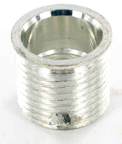

I need to look at the Riv-nuts.. Sounds like an option. I had thought about making my own standoff screws too, but using a single point threading tool, I don't think I can thread to the shoulder tight enough (#4-40, or #6-32). Is a press nut the same as a Riv-nut?
No. They are to totally different critters. I forgot all about Rivnuts. A Rivnut may be a better application for what you are doing because it will swell on the other side containing it. I was talking about a pressnut or commonly called a Pemsert. It is installed from the inside, pulled up into a reamed hole, then the serrations hold it from turning. Some have serrations all of the way up on the shoulder that pulls up into the hole. I gave my buddy my book that had all kind of that info when I retired. I see if I can find a pic.
Here's one that is similiar, but the ones that I am thinking about have a longer serrated shoulder on them. I may be calling it the wrong thing this morning.
Another one that you may want to look at it a Time-Sert. Although I don't know how small they go in size.
Here is one similar to what I was talking about, but still not what I have pictured in my mind

I went ahead and ran the prototype.. Came out good.. Broke a drill bit on one of the #4-40 holes on top which boogered (tech term) the countersync a little bit. No big deal. I also tried a corner rounding tool for the fillet's on top.. Took a little while to figure out the geometry and set it up.. Still need to debur/sand/polish.
If I use a riv-nut, I'm still going to need the offset screw into it, and then the screw from the top of the box into the offset? The box is 1.0" tall. I need to get some and try them on some scrap and see how they work..
