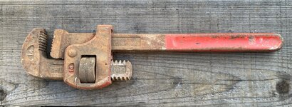

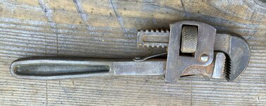

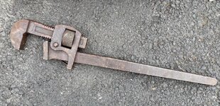

Made in Spain 10-inch Pipe Wrench
I'd think possibly "Globemaster", but the Globemaster examples I've seen use a different design and have "Globemaster" forged into the handle, so for the present it's just another generic no-name import.
Nobody-named-Olli
Jan 9, 2025
1,764
Not really sure what I have here. I found similar wrenches on this thread, here: https://www.garagejournal.com/forum...nyone-collect-them.313417/page-3#post-9746626 and here: https://www.garagejournal.com/forum...yone-collect-them.313417/page-5#post-10643978
It seems they are called “Footprint wrench”/ “Footy” / “Universal shifter”.
Information: https://footprint-tools.com/product/footprint-original-pattern-pipe-wrench/ & https://en.wikipedia.org/wiki/Footprint_Tools
I have no Idea who the manufacturer is behind my wrench, but here are some pictures.
Kind regards,
Olli
30,979
The design was copied the world over. I don't recognize that logo. Original Footprint pipe tongs, made by Ellin in Sheffield, have the Footprint logo, which is literally a footprint. Unfortunately, the brand does not have its own thread.
I remember seeing a few scattered here and there on some older GJ threads, but I know that @Stubby1743 posted tin snips with a very good example of the logo in the 'Secateurs, Shears etc' thread, here.
@3baygarage posted a knockoff of the pipe tongs made by Keystone Mfg here in the US accompanied by some fantastic period Footprint ads in the 'Oddfellows' thread here.
Lastly, @four.cycle has posted a link to another forum with some very interesting historical references for Footprint in his entry for Footprint in the List of US and Foreign Mfgrs reference he maintains here on GJ.
Footprint / see Thomas R. Ellin /
Footprint / Footprint Tools Ltd., P.O. Box 19, Hollis Croft, Sheffield, England (1981) / https://www.sheffieldhistory.co.uk/forums/topic/11319-footprint-tools/ /
For future reference, you can access that Mfgrs List in the Handy Hints and Links section of the READ B4 POSTING! Sticky at the top of the forum, page 6.

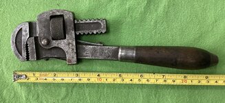

Very similar to Olli's, this "Blitz" wrench has an old D.R.G.M. number of 29923 stamped on it. This pattern of wrench/pliers was made by more than one company. Figuring out who that patent was issued to might offer a clue as to who was making these early on (other than Ellin/Footprint.)
I don't recognize that herald mark on Olli's specimen. Wondering if maybe Wolfgang's site might offer a clue on that.

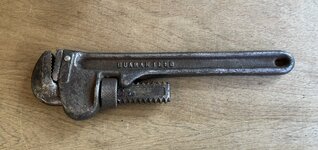

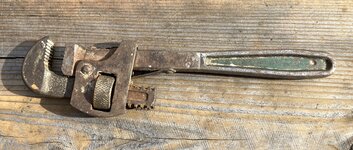

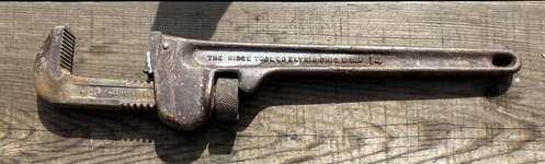

One of my rusty finds at yesterday’s estate sale was this 14” Ridge Improved Stillson. The evaporust bath improved its’s appearance except for the rusty area.
I did some work with my vertical belt sander to minimize the pitted area today.
BK’s ad blown up.

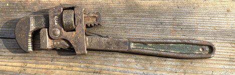

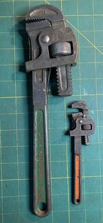

I found these three at the College Flea Market on Saturday.....
Tried to buy just the small one, but the Seller insisted on giving me a deal on all three :LOL:
As a reference, the smallest one looks to be about 6" when closed

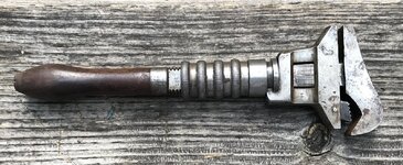

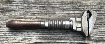

Some very nice oldies in this thread.I think this belongs here.
Hard to find info on “American pipe wrench”. :LOL:Luckily, there’s a patent date.
May 17, 1904. Comes back to:
Patent 760,063
American Drop Forging & Tool Co., Wayland, NY
Inventors: Jacob Emig and Archibald McKaig, Sr.. Hmmm, that Archibald McKaig, Sr.???!!! Hour and a half from Buffalo….
According to an article at Yesteryeartools.com, American was purchased by Warren Axe and Tool in 1907 and moved to Warren, PA.
Link here: http://www.yesteryearstools.com/Yesteryears Tools/Warren Axe & Tool Co..html
May I present the 8” American pipe wrench

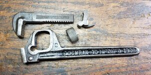

Taking the liberty of re-posting some photos of a Parmelee that @3baygarage reported in the Garage Sale thread yesterday. It appears to be a perfect example of Parmelee's fourth patent (871,436 / Nov 19, 1907), which we have not yet seen on the thread. See Pics 1 & 2 below.
There are a few examples of a much later (1915+) Walworth-Parmelee with a knurled threaded collar that locks in the grip. And I have posted an example of his very first patent (379,123 / March 6, 1888), when he was still making a go of it himself, where the grip was maintained by keeping manual pressure on the cam. See Pic 3 below for comparison purposes of those with the one 3bay just found.
As far as I know, we haven't yet seen any examples of the two intermediate improvements - 590,853 (1898) and 648,706 (1900), when he continued tinkering with a way to lock the jaws in place.
DATAMP is down, but tomorrow I will post links for easy access to the patent diagram that 3bay's find matches.

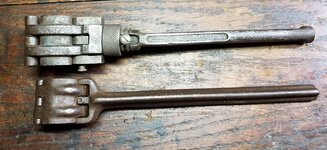

@AreBeeBee and @HeelSpur posted examples of Cochran pipe wrenches upthread. But I didn't see any photos of one disassembled, so I'll add those. As I've mentioned before and elsewhere, the most extravagant but stable "stabilizer" I have ever seen. Not only is the adjusting knob snugged in by that pivoting piece, the nut and the whole dynamic jaw is snugged in by a very stiff leaf spring. There is literally zero slop.

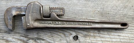

Picked this up for $10 this week. The previous owner “DHJ” stamped his initials over the makers mark, but it’s easy to make out J P Daniel Son Co, Stillson Pattern, Jamestown NY USA. The number 10 is cast into both sides of the head, and there might be something else cast into one side if the head. Any idea what date it could be?
OmegaDPW
Mar 14, 2025
56
Deep South, GA
I recently found one exactly like this except for a blue painted handle. Mine is an 8 inch JPD wrench and has an "8" stamp. I'm assuming that's just a size stamp, but I know nothing about mine (yet!)20250319_165154.jpg
Old tool guy
Apr 13, 2023
3,513

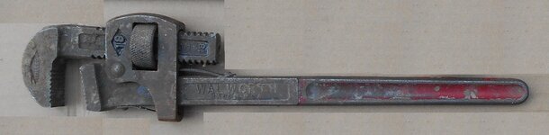

Paid too much for this, but i didn’t have one like it.

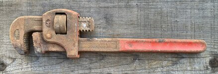

Stamp on the handle says “Stillsons wrench, pat aug 1882 (i think), walworth mfg co, boston usa”. Logo on the head looks like this:
but the pat date on the trademark sheet doesn’t match what i think i see on the wrench. Also saw this on the site with the trademark sheet: Walworth Manufacturing is most famous as the original maker of the Stillson pipe wrench, named after its inventor Daniel Stillson, who was an employee of the company at the time. The original Stillson design was covered by patent 95,744, filed by Daniel Stillson in 1869 and issued later that year.
30,979
If by "trademark sheet" you mean that table you excerpted from AA, you are confusing trademarks and patents. Those dates are when the trademark for that logo on the dynamic jaw was first used and when it was issued. While they are both administered by the same office, TM's are for names, marks, or logos used in commerce and patents are for unique design or utility.
"The original Stillson design was covered by patent 95,744, filed by Daniel Stillson in 1869 and issued later that year."
That's true. Walworth had a couple improvements on the first patent, though, which AA doesn't address, doesn't include in their patents table, and doesn't have any examples of.
That date refers to patent 262,263, issued August 8, 1882, to Caleb Walworth. It superseded the original and subsequent (126,161, issued April 30, 1872) Stillson patents.
While AA can be a helpful source for background, examples, and summary information on tools, their center of gravity is vintage era mechanics' tools and the scale, scope, and well-organized look of the site can be misleading when they dabble incompletely in areas outside that and don't mention that they are dabbling incompletely. DATAMP is a much better source for patent info, especially for antique tools.
EDIT: Better link...
Old tool guy
Apr 13, 2023
3,513
I am in awe of your knowledge and your research abilities. And you’re right, I am confused about trademark, patent, service mark and similar things. I like to do enough research to learn a little history of the tool and the manufacturer, and to establish a reasonable date range, and i appreciate your input.

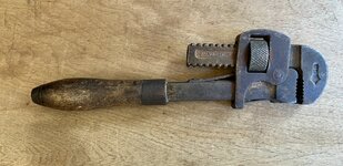

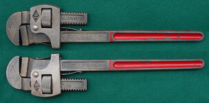

Here are the pipe wrenches I found at sales yesterday and today. First is a 10” wood handle Stillson made by Walworth who held the original patent. IMG_2533.jpegIMG_2534.jpegIMG_2535.jpeg
Next is 10” wood handle Trimo. Patented 6/20/16.
16,692
I added the new Walworth and Trimo pipe wrenches to the others in the pipe wrench drawer.
Back in the pipe wrench drawer. IMG_2567.jpeg-Don

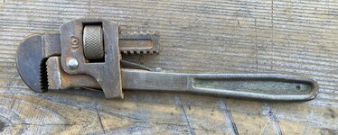

I was amazed to find that this old Walworth Stillson was in such fabulous condition after cleaning it up a bit. The "before" photo is below:
Walworth Mfg. Co., Boston, Massachusetts 18-inch "Stillson" pipe wrench
