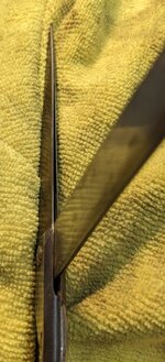

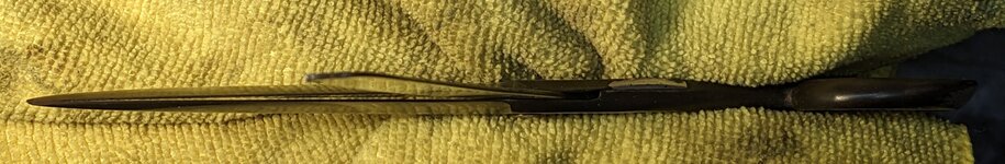

I'm thinking someone else already posted a pair, but I picked these today:
Interesting design. Double-action for more force, double blades instead of blade and hook and the spring holders for whatever you've cut. I'd usually think of these as being for cutting flowers, but they do say Pruners.
There's a hook, like you'd expect for latching them closed, but there is nothing for the hook to latch onto--and no evidence there ever was. The hook rotates 360* in either open of closed position.
They're just sharp enough to use. To sharpen them properly, I'll have to file off the peened ends of the screws that secure the blades.

Fresh out of the ultrasonic cleaner, with a nice coat of CLP:
They cleaned up real good.
Outlaw--Every single screw is peened. A file or careful use of the angle grinder will get them off. Not sure they're really worth the bother. Cool, but...
I just tried them out on a willow out back. Definitely for cutting flower stems! A stem the dia. of my pinkie finger was a struggle. I'll stick with my Felco 7s and give these to the gals up in the pub for cutting flowers--until they lose them.

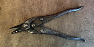

I had a very cool find this morning at the flea. Wiss Model U.C.8 tinners' snips. They date precisely to 1931-1932. First of a kind, as far as a search reveals, for the entire site. I certainly didn't know they even existed when I first spotted them at the flea market. I was struck, of course, by the unusual configuration. I have all kinds of tinner's snips, mostly from Wiss and Crescent, mostly wartime, 7" combination pattern cut, because they were in the GMTK, and matching 11" straight cut, because that's the pair that was in the Radiator and Sheet Metal Mechanics' kits. They all have the instantly recognizable shears-type finger guard pattern handles characteristic of tin snips. In 1931, J. Wiss & Sons decided to do something different by configuring their combination and straight cut snips with handles more commonly associated with pliers. They branded them "Nu-Grip" and applied for a patent on March 2, 1931. It was granted on January 17, 1933. They advertised them in catalogs and in trade mags between 1931 and 1944. By 1950, they were obsolete.
Some photos of the example I found, a catalog cut, and the USPTO Gazette entry...
30,923
Precursor to the compound aviation snips that came later.
I wasn't thinking of it that way, but yes, that makes sense. The compound action snips, which Wiss branded "Metal Masters", were not offered in the 1937 catalog and had to have been introduced sometime between 1938 and 1940. They appear in the 1941 catalog with a note on the optional rubber handles being a new improvement.
EDIT: When WISS trademarked "METAL MASTER" for compound action snips in 1955, they claimed first use in 1939.

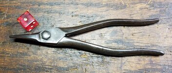

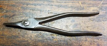

Here's another pair of Wiss:
Barely legible--even after playing with the lights and boosting the hell out of the contrast--but says Wiss USA ?10. I used a field microscope to look closer, but no help. It does look like there was something before the 10, but it's gone. Maybe acid-etch like the cops do to raise filed-off SNs on weapons?
Anyhow, still have scraps of the original gray paint. Lugz's picture above shows how it was masked, so I just need to find the matching color of gray.

I gave the old shears an hour or two in the electrolysis vat with hot lye solution yesterday, followed by 4-0 steel wool, a stainless toothbrush and a few ounces of elbow grease:
Some interesting details:
Instead of having three triangular stakes on the locknut, the end of the pivot pin is peened.
The head of the pivot pin is chamfered instead of domed. The Wiss USA and 10 aren't in a cloud, and there is no letter prefix on the 10. In the early (1937 and back) catalogs I looked at, the tin snips had no prefix, but they had the Wiss cloud. By '63, the next catalog I could find that included tin snips, this pattern would have had a V- prefix and the casting marks would be Wiss and Drop forged--not Wiss Forged and Solid Steel.
They need paint. Based on the remaining scraps of paint on them and the pictures you all posted above, I tried to get a decent match--not easy where the hardware stores no longer carry much hardware nor paint. I tried to copy the masking shown in the pictures and chose Rusto Smoke Gray as about as close I could get hereabouts:
Another use for a saw filer's vise. I've removed the masking and I'll give 'em a good bake (1 hour at 250F) after another hour of cure time. I've moved them from where I painted them to keep them in the full sun a little longer. After I bake 'em (and let them cool), I'll hit that gloss paint with some 4-0 steel wool to dull it a bit and blend the masking step.
