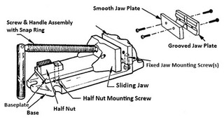

Nice looking vise! I wish I had one for my drill press.
Found this parts list image showing the baseplate that as others have described and you have proved is removable and reversible.
Also found these links to new replacement baseplates.
Learned a new word "vivisected"

Larry; thanks, and thanks for the links. Somehow, when I looked up the vise before, I didn't see "base plate" on the parts list...so that was my mistake and would have saved us all some time. However, I've now rectified that omission, and I've found that the cost of a replacement baseplate is effectively no more than the cost of shipping a small piece of steel to me so that I can make one. I looked around, locally, and I've had trouble finding a shop that carries stock that thick, and whom will sell a short section; I'm sure someone does and will, but I haven't run across them yet...so for $65, I can get that issue fixed. That's inexpensive, compared to spending more time calling, fetching and producing.
