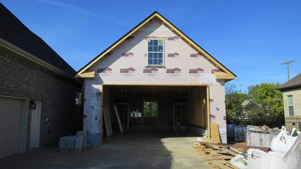

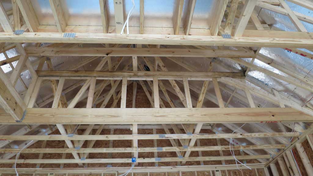

10/3/2015 update continued as 1st post hit the character limit:
Update 10/3/2015
Been a bit busy, so this will be a pretty big update.
Concrete poured (4,000 PSI 4" thick except where lift posts will be and that's 8")
Christened :)
Frame package delivered
Framing started
And finished
Closet for compressor
And restroom

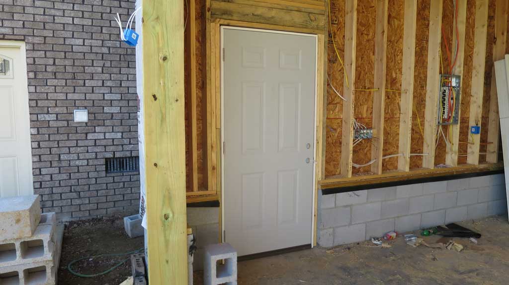

Man door
Roofing completed (architectural to match the house)
Electrical roughed in (house upgraded to 400A service with a dedicated box in the shop)
5 gang switch box by man door. Lights are wired in 2 banks on 3-ways to 5 gang by compressor room. Switches for exterior door lights, cans, and attic which will be illuminated so I don't forget to turn it off.
5 gang at compressor room. Light bank 1 and 2 - 3-ways; light/fan combo fan, light, and finally a switch to turn on compressor. The light and compressor switch will be illuminated on so I don't forget to turn them off.
4 20A outlets on one side, 5 on the other, and 4 on the back wall.

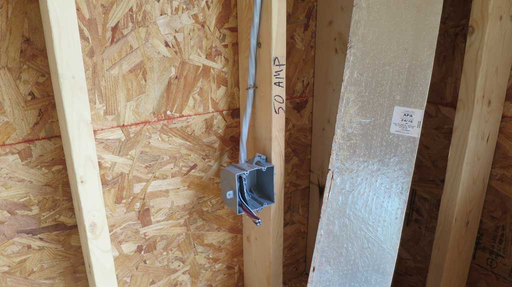

50A plug for big stuff like a welder

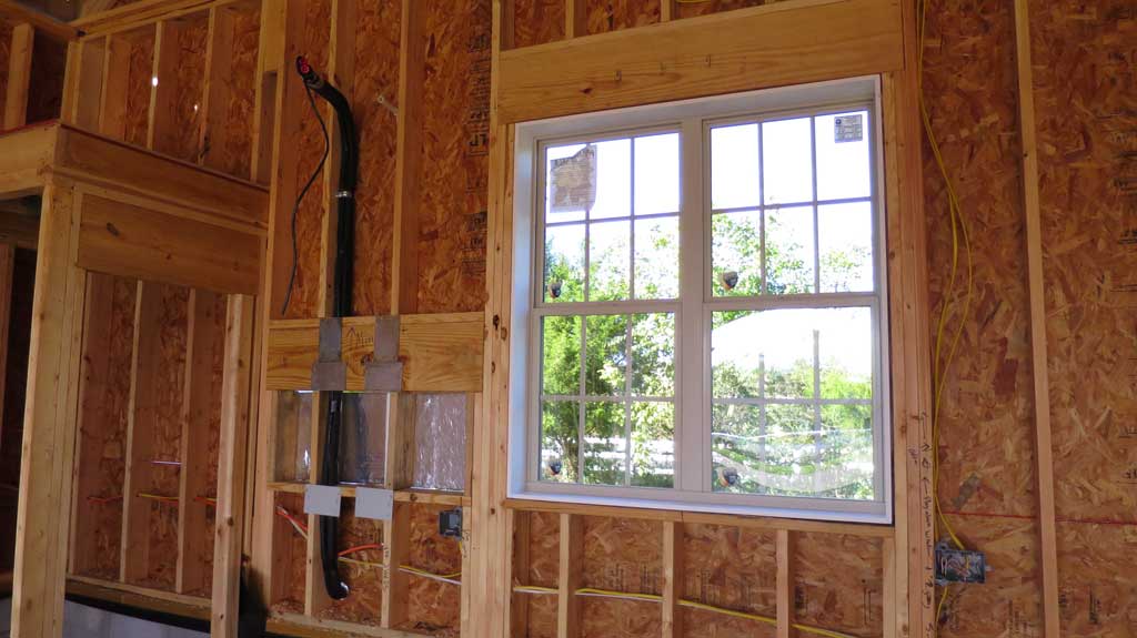

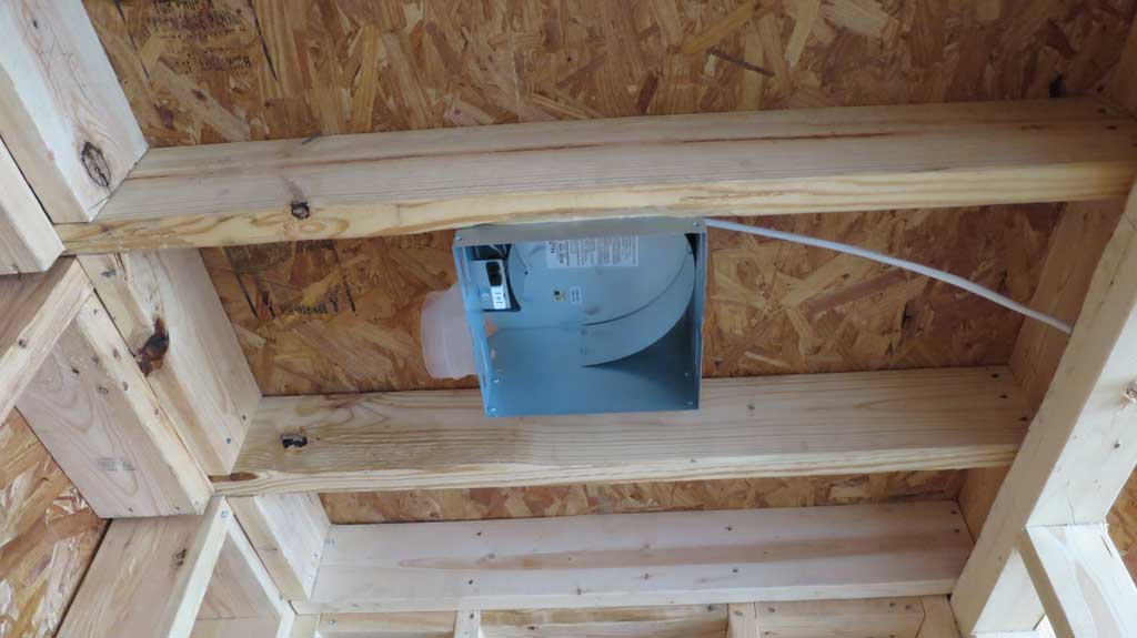

Light/Fan combos in the compressor room to evacuate heat when needed. Another in the bathroom as standard.

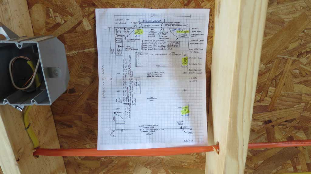

To get this done the way I wanted I left a VERY specific diagram for the electrician.
Framers finished the recess in the ceiling to give clearance above the lift.

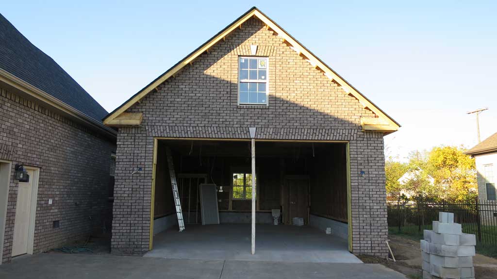

Getting close.

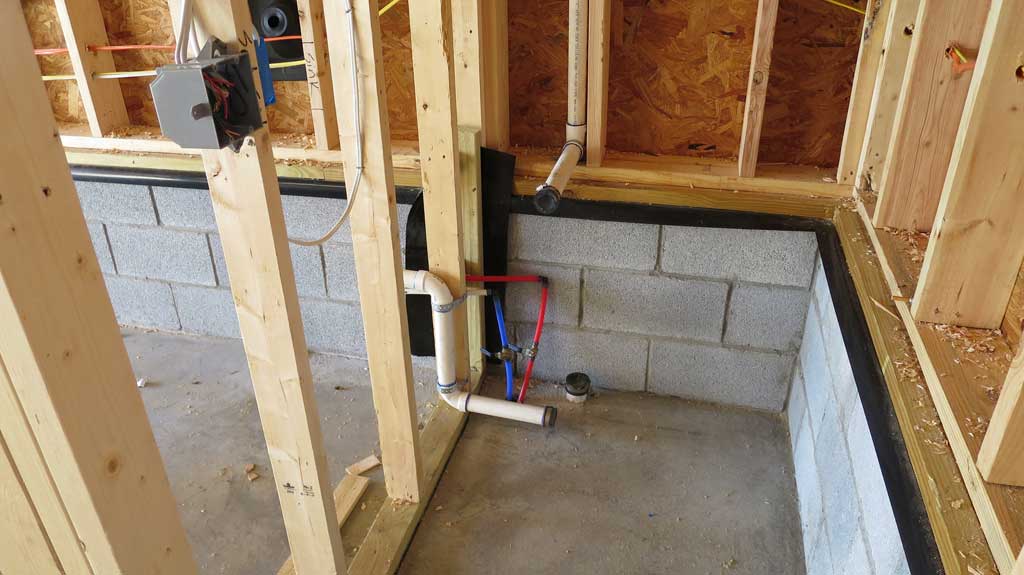

Windows and line kit for mini split installed. I decided to upgrade to a mini split over a PTAC. It was a bit more money but will pay for itself in the short term with the MUCH higher efficiency. Thanks to those that recommended I check in to it as an option.
Plumbing almost complete. They still need to run the lines for the internal shop faucet and install the toilet.
Man door installed.

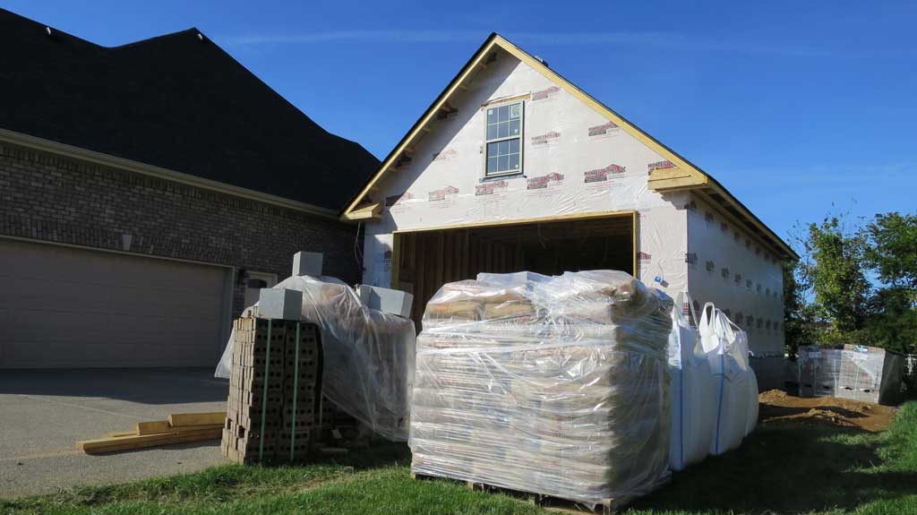

Brick package delivered. They should start bricking this week.

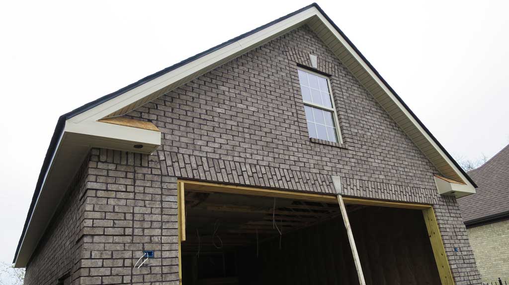

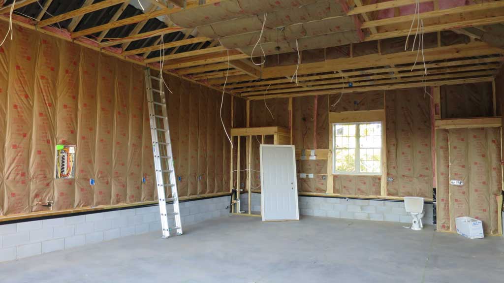

On the home stretch now.
Brick work is complete.

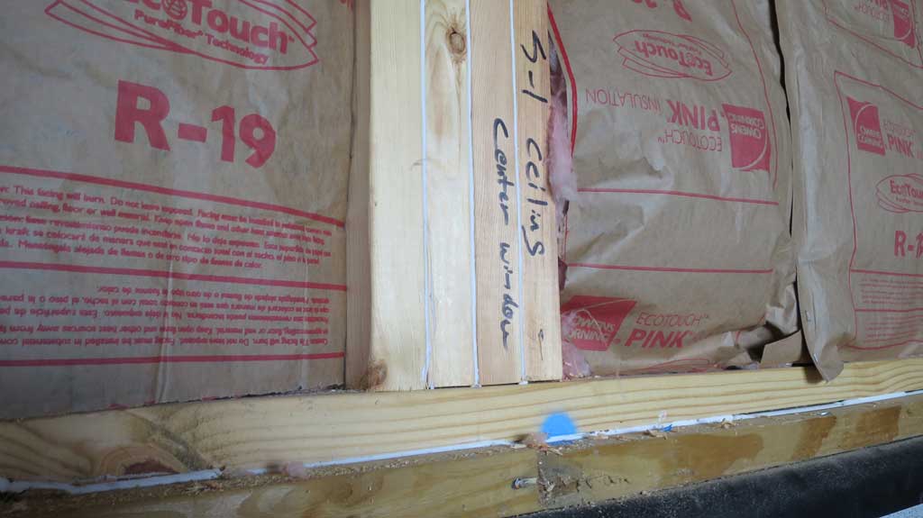

As is the insulation (R-19 on the walls, R-38 on the ceiling, the rest will be blown in). Notice the compressor room is insulated to help with sound abatement. There is an exhaust fan in the ceiling if needed for heat control, but I doubt I'll have issues.
They also caulked ALL seams in the frame on the interior.
Low voltage is next for internet, satellite TV, and alarm system, then sheet rock which should be next week.

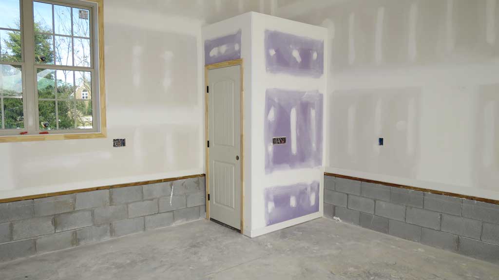

If it's not too late, read up a little on insulating the compressor closet for sound. I am not an expert but I know a little. The fiberglass will do almost nothing, it doesn't have enough density. There are many specialty materials that you can use but at this point, I think your best option would be to just have the drywall guys put two layers of 5/8 standard drywall with adhesive in between the layers on both the inside and outside face of the two closet walls.... ceiling too. I didn't look close at how your fan is mounted and ducted but be sure it doesn't become a megaphone.

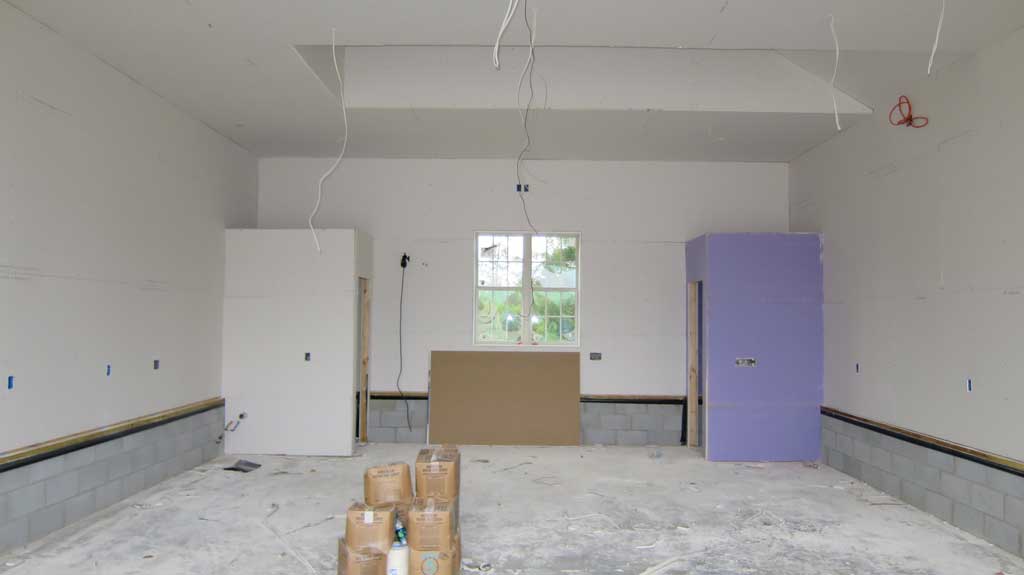

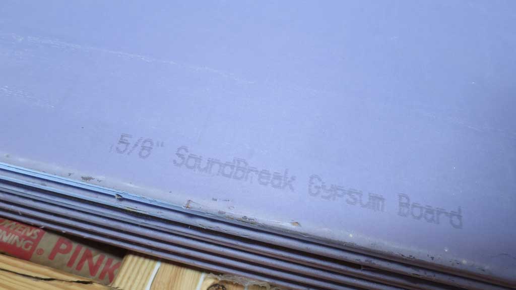

A Quietrock sheetrock product is being used for the air compressor closet. It was delivered the other day and looks like two pieces glued together with some kind of sealer and the outside paper is a bit different from the normal stuff.

The gent came yesterday to run the rest of the low voltage for coax (satellite tv) and data cat6. He had to run the cables from the garage to the house then up in to the attic, and finally down in to the media closet where all the connections are located. He got it done and made it look a lot easier than I thought it would be.
However, when it came time to run the cables from the house to the garage there were problems that shouldn't have been there. Gray PVC pipes have been put in place to go from the house to the garage which is only about 7 feet or so apart. A big 3" pipe for all the electrical and a smaller 1" for the low voltage. He gets all that cable run through the house then finds the 1" pvc pipe is packed full of mortar from the brick work. It seems no one capped the pipe after it was run. He had to dig the pipe up (3 feet down) to get the elbow off and clear it. Got it done, but with the time change and the weather being nasty it wasn't a fun job. I ended up helping him finish up running the cables so he could get home at a reasonable time but a 2 hour job turned in to a 5 hour by the time it was all said and done. Amazes me that some foresight isn't used in these situations to put caps on any pipes until ready for use, or at the very least some duct tape to keep the clear. I wonder how much mortar is gonna be in the big 3" pipe for the main electrical lines.
With that over, sheetrock should be going in this week.

Is that some sort of special toilet set up like maybe a rear discharge? I've only ever seen them with the floor waste pipe needing to be centered 12" from the back wall. It looks like yours is closer to the wall ? Maybe it's just the angle.
I'm curious because I'm finishing my basement and my final plans made me wish I would have placed the waste pipe about 10 inches further north so I don't have to job a wall around it to create a 3' wide area that is 12" from the pipe.
S
Speedy!
Dec 23, 2014
271
TN
Since the garage is below or the same level as the house plumbing I had to use a grinder pump on the toilet for waste water.

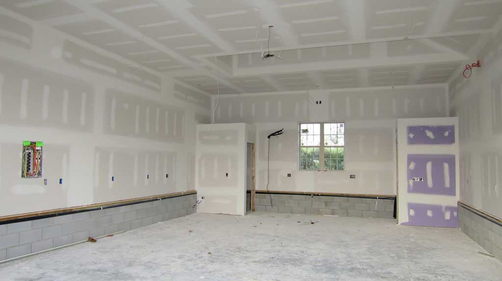

Soffits installed:

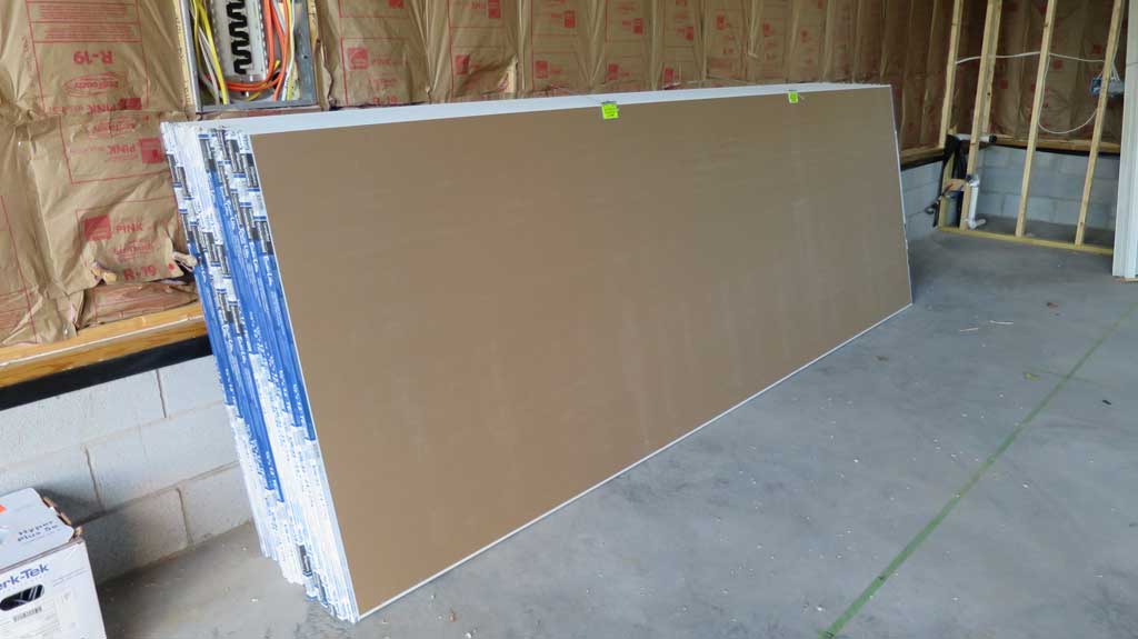

Sheet rock delivered:
Soundbreaker board for compressor room to deaden noise.

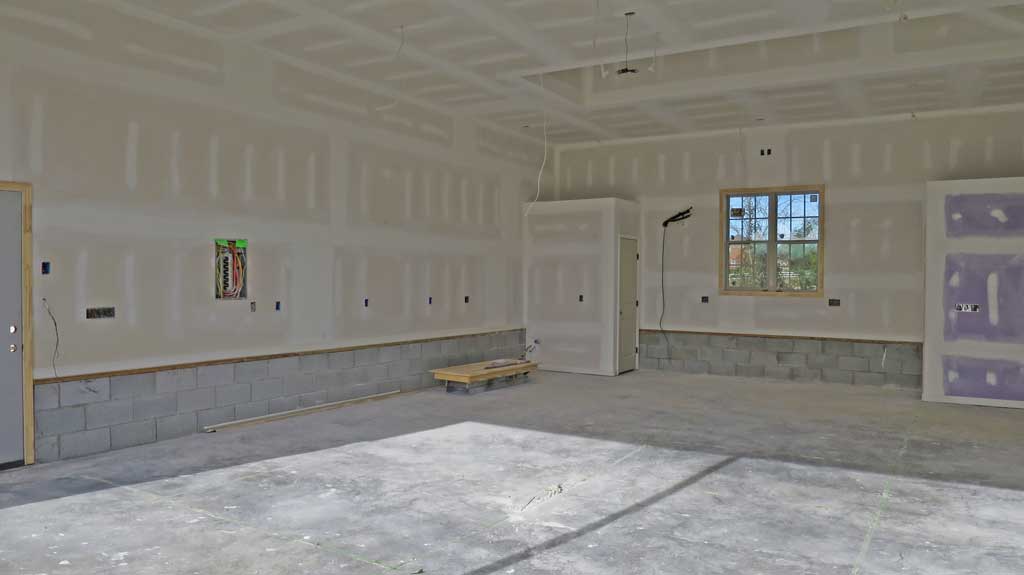

Sheetrock complete:
Finish work started - 2 coats as of this update. I think they'll do one more and should get that done early next week.

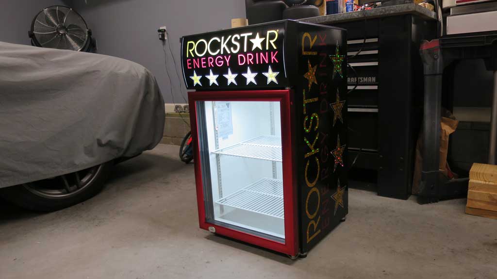

I picked up a fridge for cheap to go in it as well. Thank you CraigsList :)

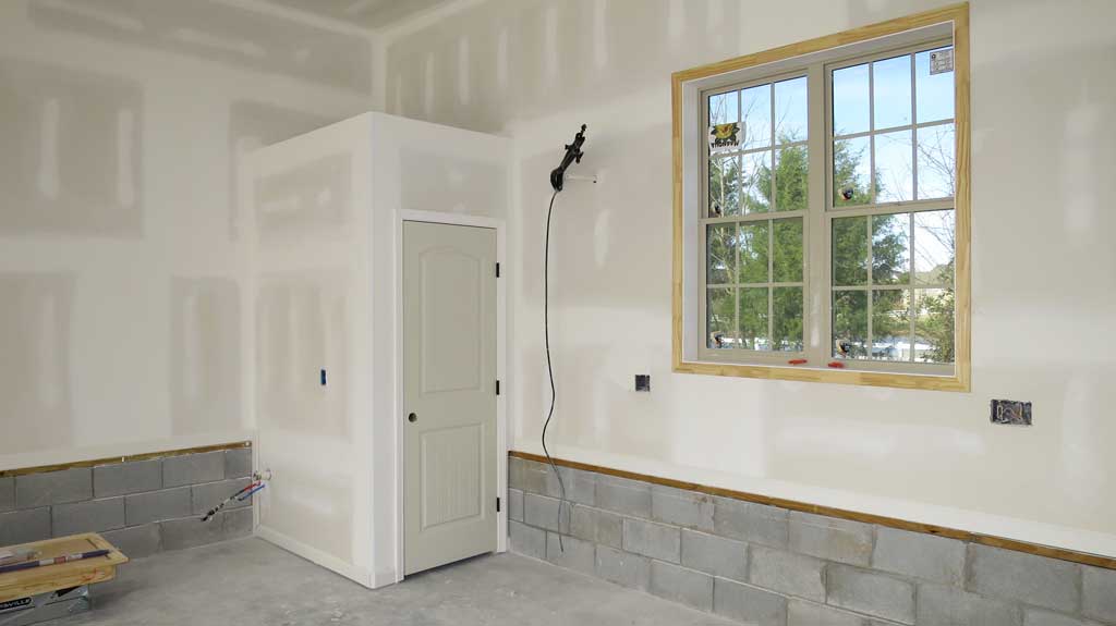

Quick update. They did 3 rounds of finishing on the sheetrock and got that knocked out. Trim guys came by and got all the trim/doors installed this week. Amazing how fast these guys can work and how good the work actually is. They showed up at 4pm and were done including clean up at 7pm.
Paint is next. I had planned to get some buddies to come over and paint it ourselves, but it's getting cold weather and close to the holidays so I'm taking quotes from pros now. Hope to have the paint done next week if I can get it scheduled. Shouldn't be long after that, final electrical, gutters, attic insulation, main door, and the final plumbing are what's left.
Solid exterior metal door used on compressor room for sound deadening.
Standard interior door used on restroom.

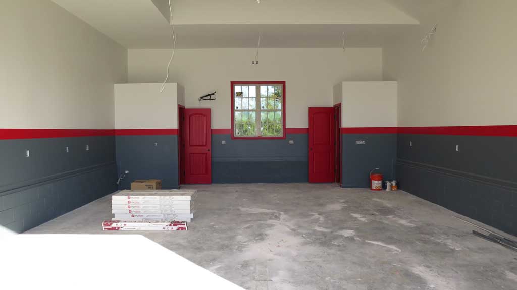

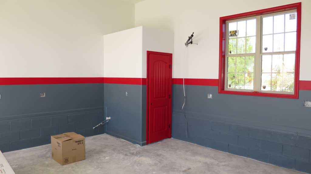

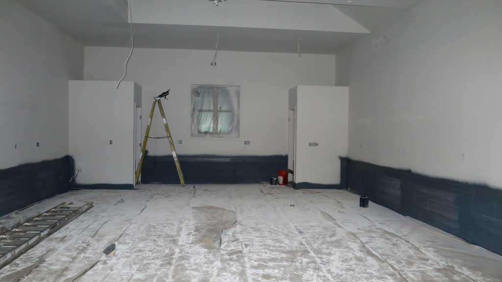

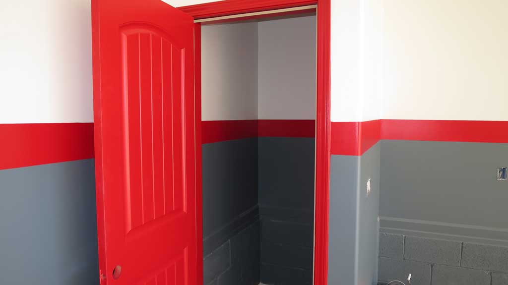

Got the paint work complete this week. After watching 4 professionals work on this for 3 days, I'm glad I hired it out. Cash is king, so keep that in mind when working with contractors if you want the hook up ;) I was shocked how inexpensive this was to get done and it looks fantastic. Took them SEVEN COATS on the red. I'd have gone nuts.
Primer coat (they then had to sand the walls smooth the next day)
Paint finished. It has flat ceilings, eggshell walls same color as ceiling, satin for the gray including block, and semi gloss for the red.
They even carried the same scheme through to the bathroom and closet!
I wanted the paint to give me a nice hot rod feel to keep me motivated and to make it enjoyable to be out in the garage and this is the ticket for me.
Electrical package was delivered as well and that's next a long with the garage door. Once that's done I'll have the HVAC mini split installed, diamond grind and epoxy the floor, attic insulation, and final plumbing. I think that's it! Probably 2 weeks out.
