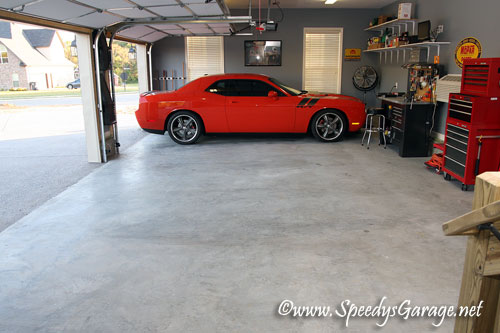

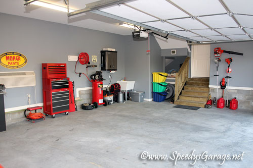

Here's the current garage. 3 cars is nice, but it needed to be about 6 feet deeper.

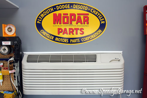

18,000 BTU TPAC - works great to cool this space down to 70ish degrees in 90+ temps with 60% humidity.

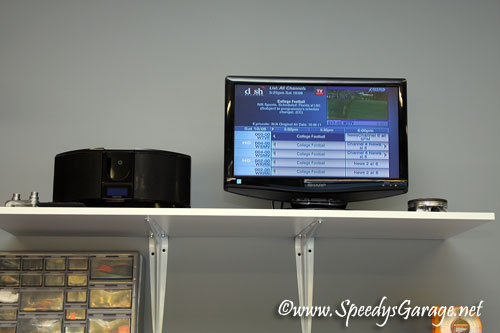

One of the best things I did - satellite in the shop. I wear out Alt Nation on Sirius. New shop will have this for sure.

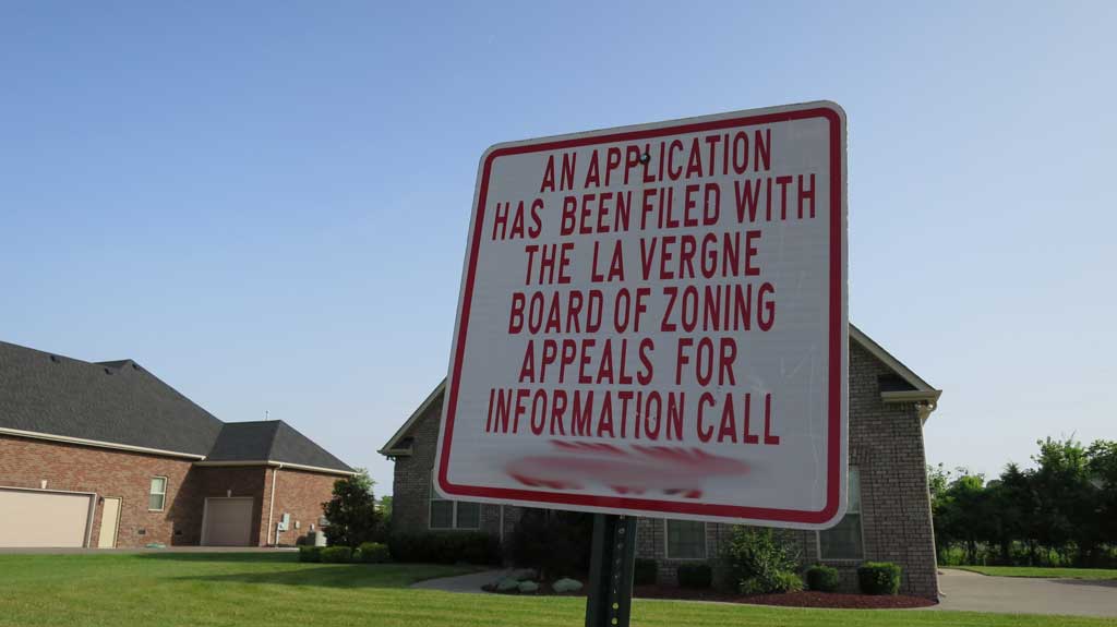

Here's the giant sign that had to be placed on my front yard for 30 days to get the city variance to build the garage the size I wanted. Went through unanimously no problem on the city vote. Bottom line, make sure you cross check EVERYTHING before starting a project like this. This held me up about 6 weeks as I got some incorrect information from the city inspector.
Staked out the location. This caused a massive fight with a neighbor who's an attorney and threatened to sue me. Once she learned the city had approved she didn't want to continue the fight :) Not sure how she missed that sign in my front yard but she claimed to not have been informed. Meh. She and her husband must not communicate either as he and I had discussed it for months.

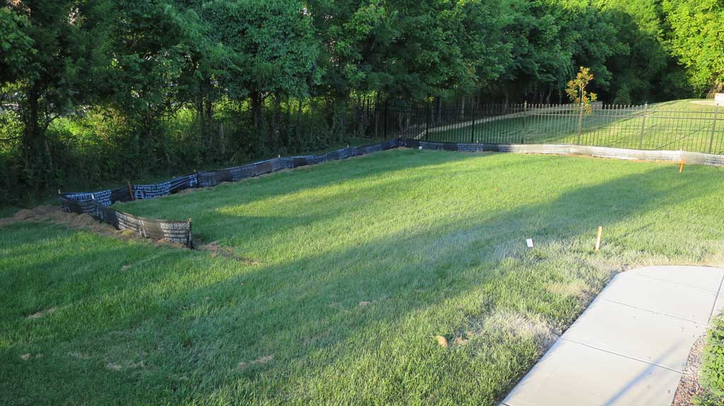

Silt fence installed.

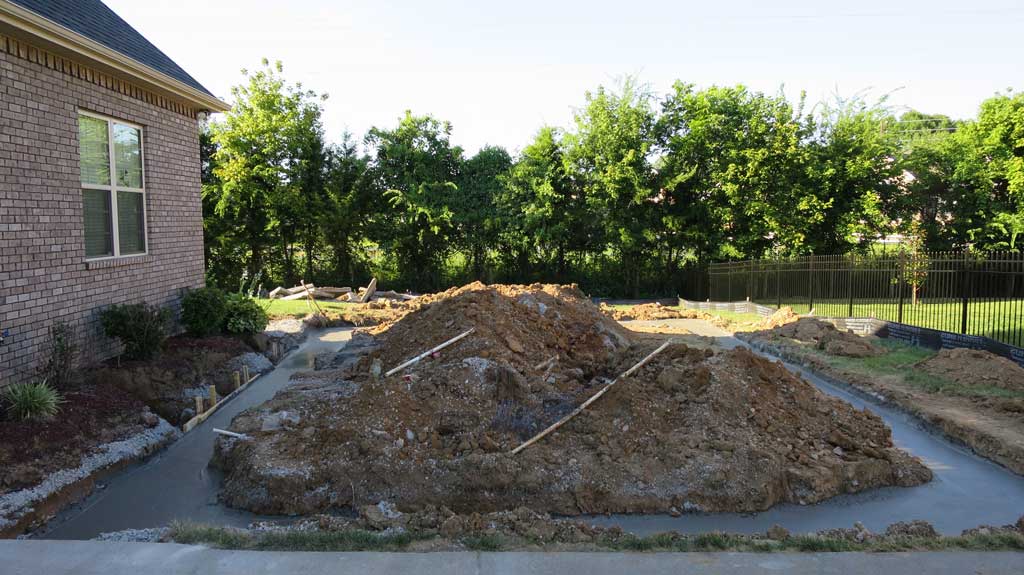

Footer dug.
And poured.

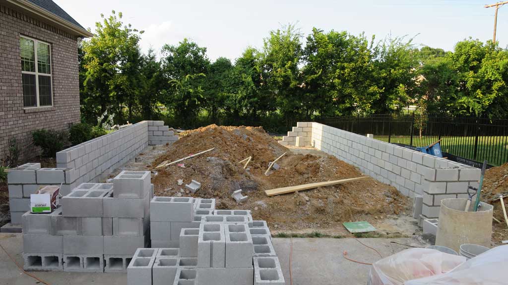

Update 8/16/2015

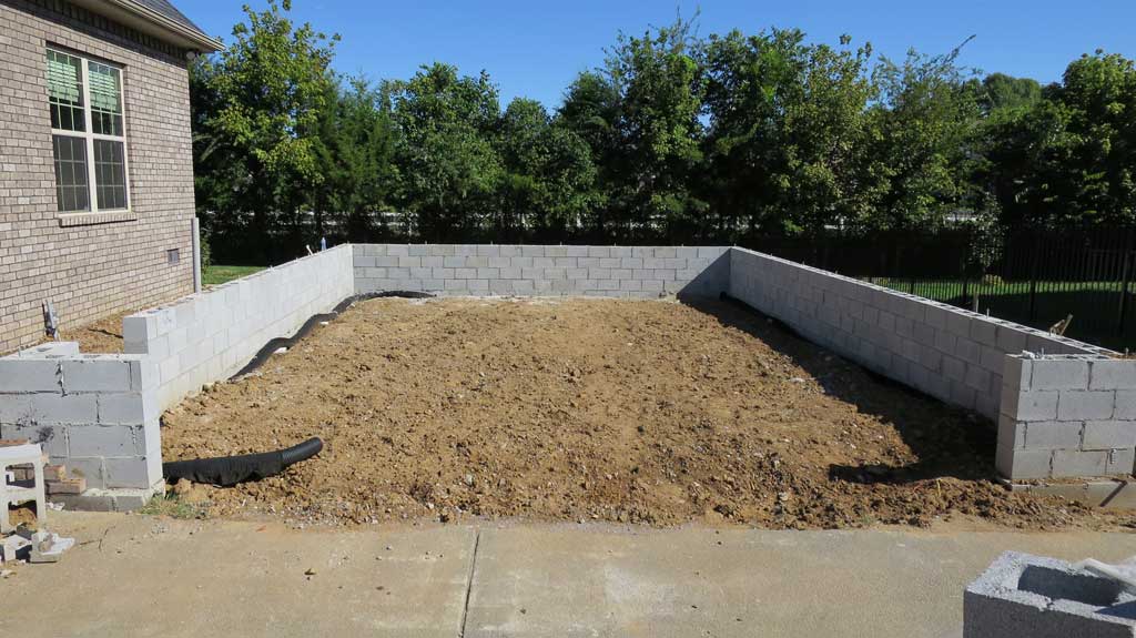

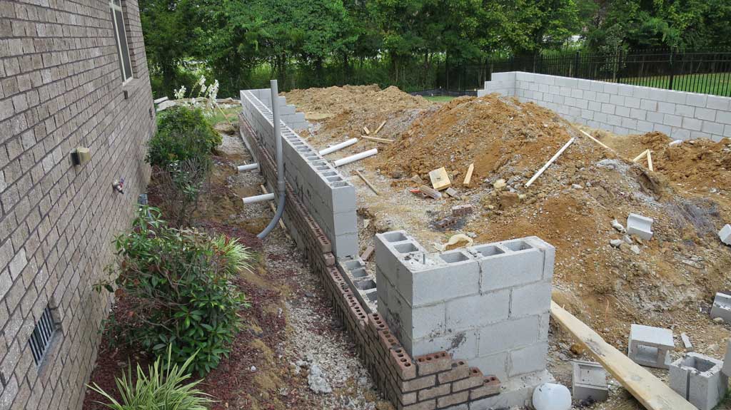

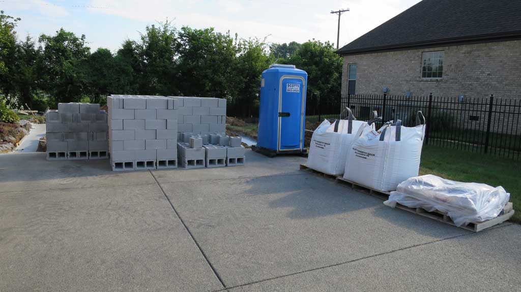

Foundation block was delivered this week.
The corners laid out and the foundation started. The builder gave me a little extra width, as much as would fit on the footer making the brick to brick 24'8".
They also went ahead and put in a few rows of brick on one side so they can grade that part of the garage. The builder told me they're trying to be careful with the yard and general "mess" to avoid as much inconvenience as possible. Some tubing was also installed for water/electric from the house to run through.

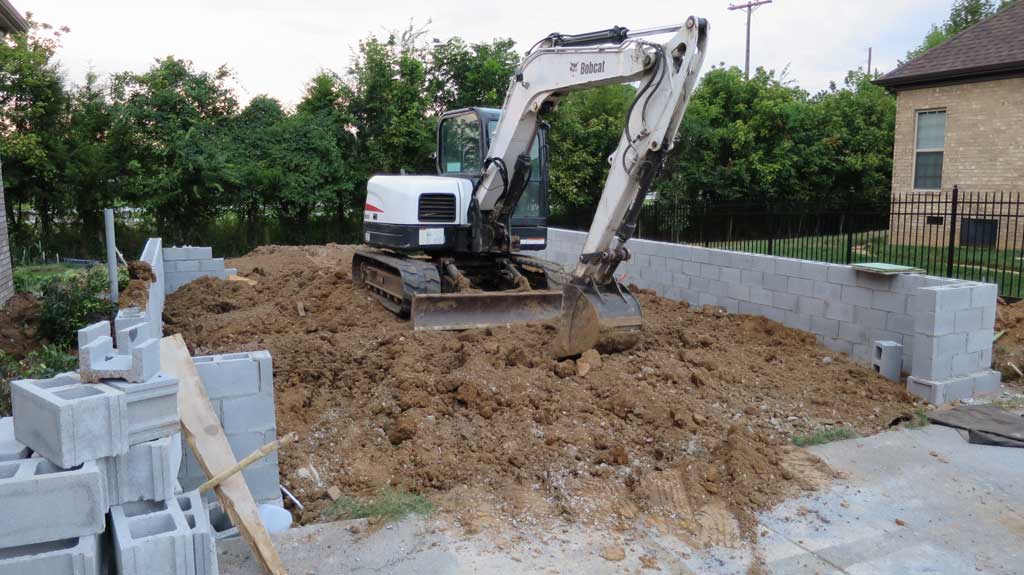

After more delays than I was happy with due to equipment malfunctions and some other properties the builder has been working on I made a call to my Realtor who lit a fire and got them moving again. For three weeks no work was done, then more was done in a single week than during the whole build so far. Concrete should be poured tomorrow.
The broken down excavator was finally repaired and delivered to clean up the area.

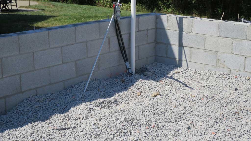

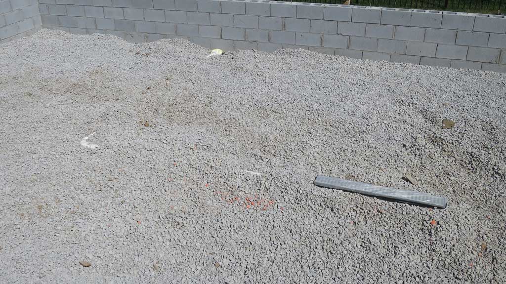

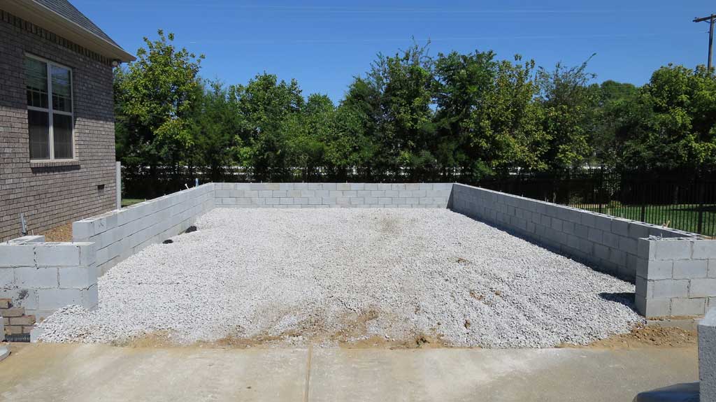

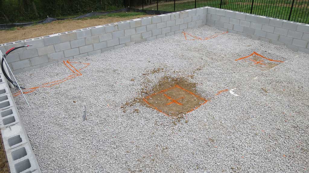

Excavated, leveled, and drains installed as a precaution.
Gravel poured
Plumbing prepped for the bathroom/ shop sink.
Floor drain installed
Recesses dug out for 8 inch thick 36"x36" pads for 2 post lift location. Concrete will be 4,000 psi 4" thick and 8" think in these two areas.

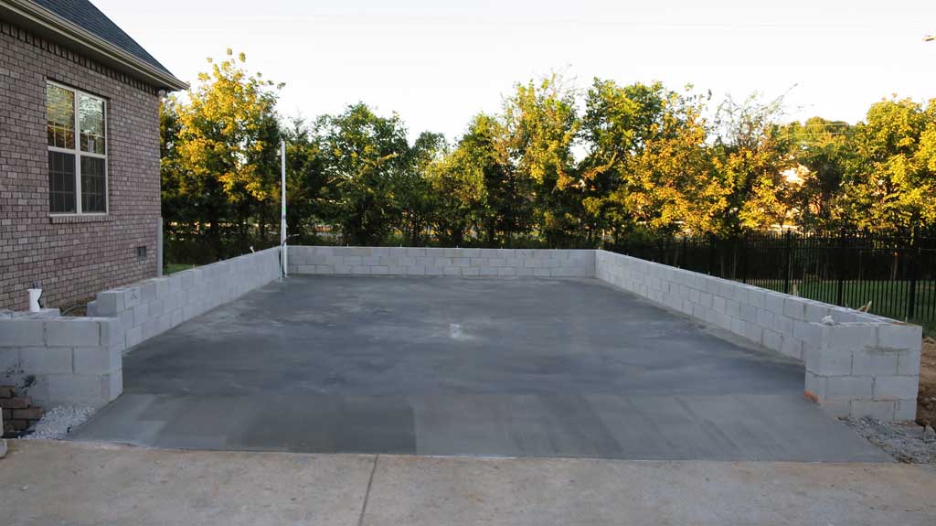

Update 10/3/2015
Been a bit busy, so this will be a pretty big update.
Concrete poured (4,000 PSI 4" thick except where lift posts will be and that's 8")

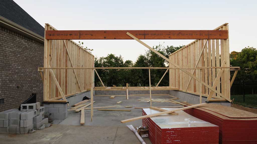

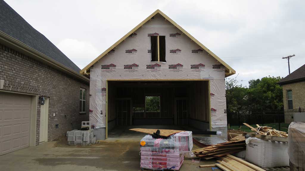

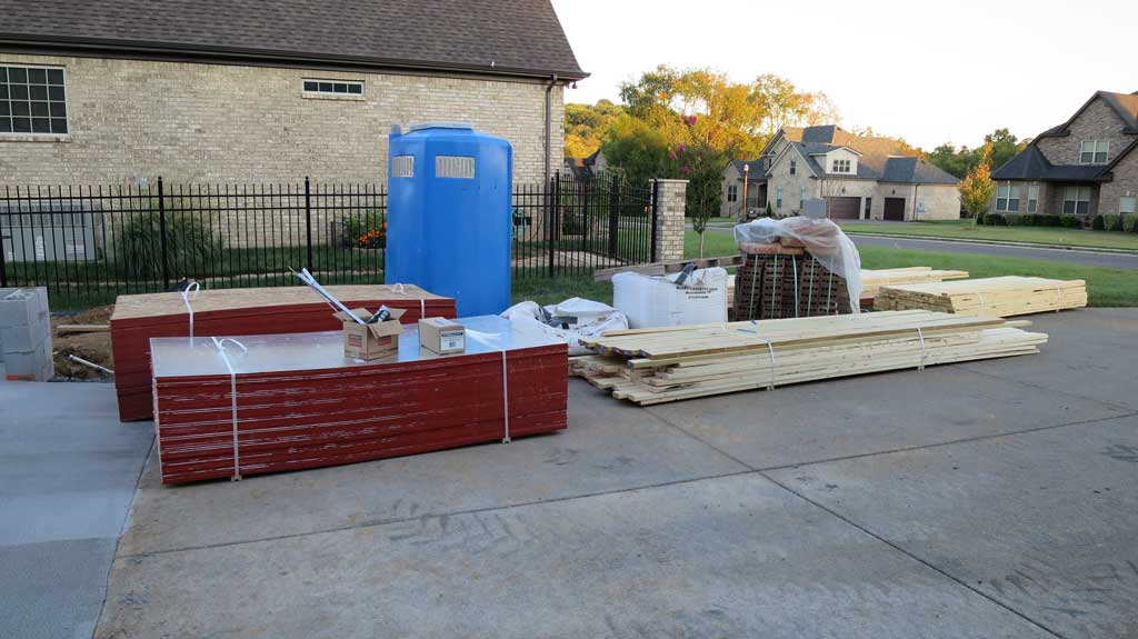

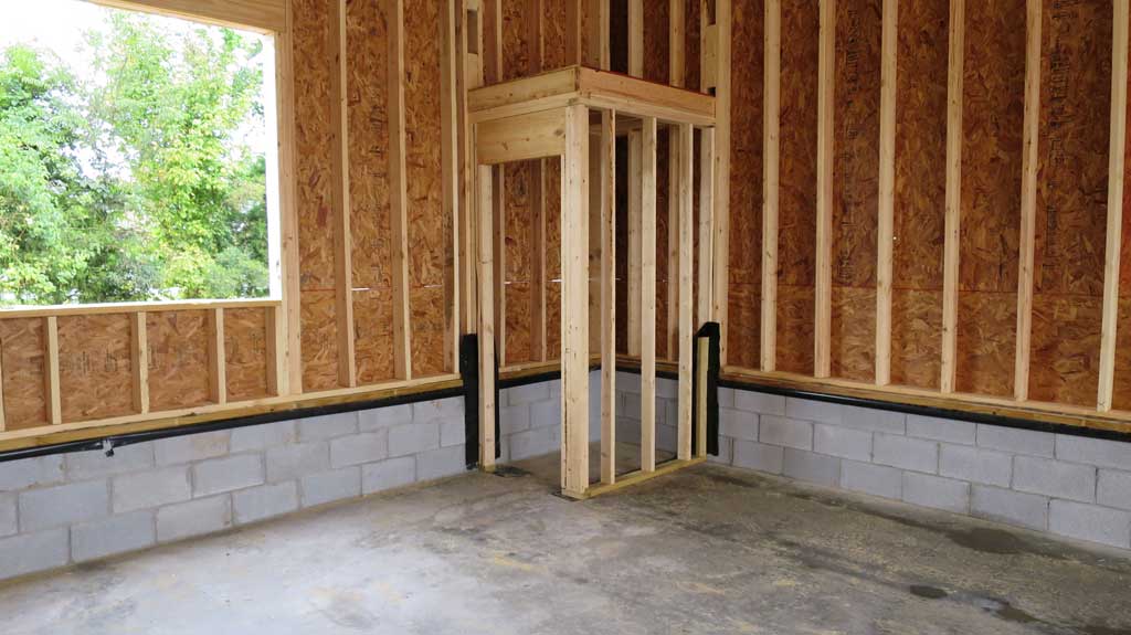

Frame package delivered
Framing started
And finished

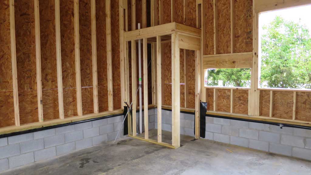

Closet for compressor
And restroom

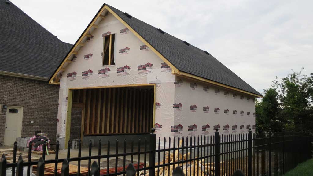

Man door
Roofing completed (architectural to match the house)

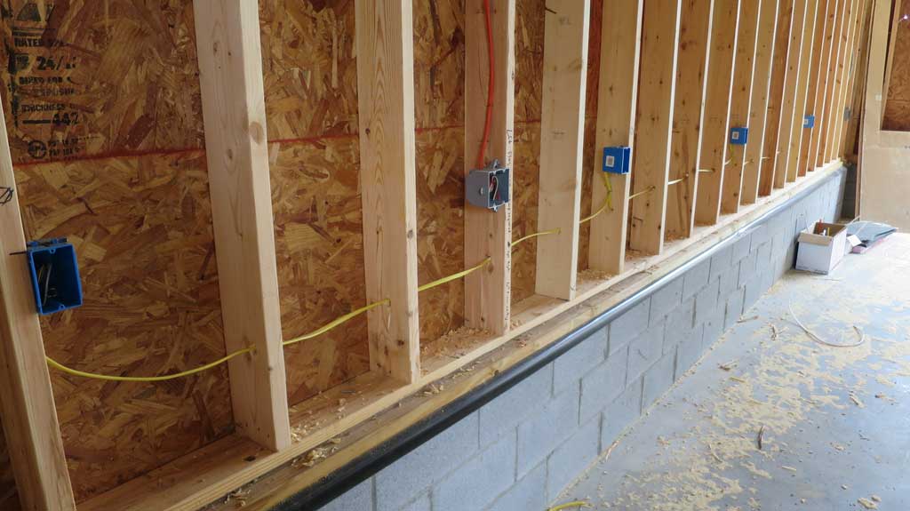

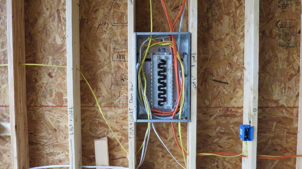

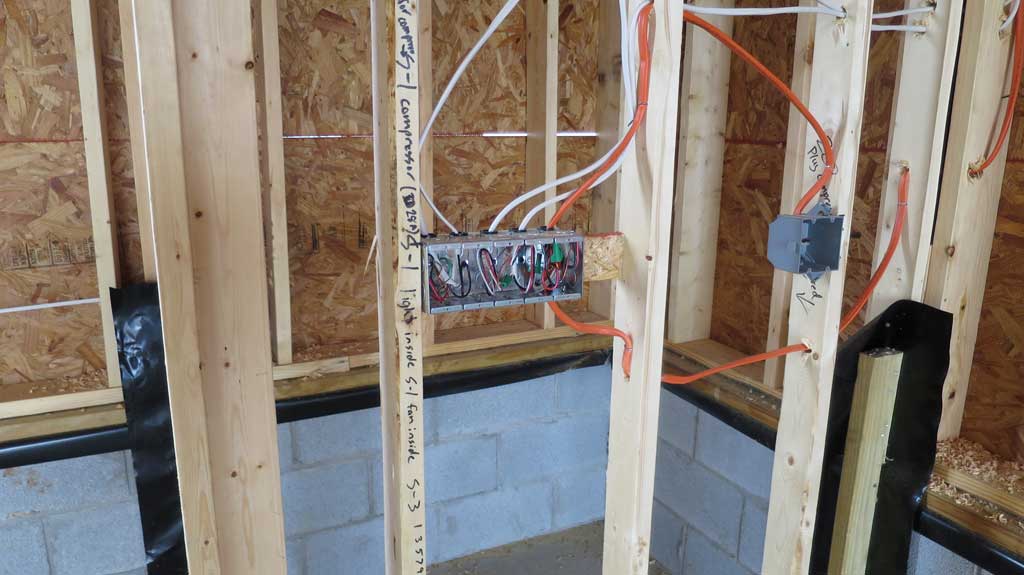

Electrical roughed in (house upgraded to 400A service with a dedicated box in the shop)

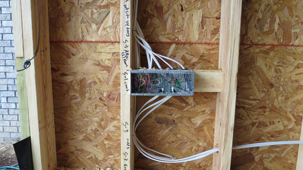

5 gang switch box by man door. Lights are wired in 2 banks on 3-ways to 5 gang by compressor room. Switches for exterior door lights, cans, and attic which will be illuminated so I don't forget to turn it off.
5 gang at compressor room. Light bank 1 and 2 - 3-ways; light/fan combo fan, light, and finally a switch to turn on compressor. The light and compressor switch will be illuminated on so I don't forget to turn them off.
4 20A outlets on one side, 5 on the other, and 4 on the back wall.

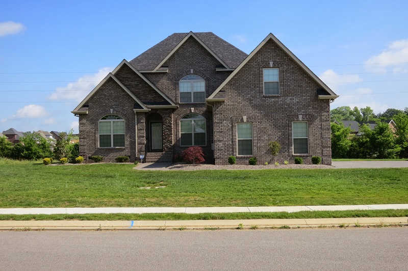

Here are is a picture of the house and the area the garage will live at the end of the drive. The sidewalk may get moved closer to the house to give room for more width, that is TBD.

Ok time for an update. They city put a big *** sign in my front yard for a month stating I was asking for a zoning variance. I was expecting a small realtor sign like other cities in the area but seems we're special here LOL This thing was on a 8 foot steel pole with a 3' x 3' steel reflective sign with big red letters "An application has been filed for a zoning appeal". You'd think I was asking to put a ********** in the front yard.
Anyway, paid my $100 application fee, in and out in 8 minutes and got an approval for the variance. Delayed me about 6 weeks, but worth it to have this thing where I want.
Construction should start soon and I'll start posting up pics.
