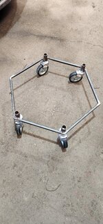

I started by making a hexagon out of 1/2" square tube. I cut out a 60* slice and bent the tube in every corner. As for the wheels they are 4" casters from HF. The wheels are screwed into a 1/2x20 nut i pressed into that round tube and welded in place.

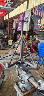

Next I created the middle section. The upright piece is 1 1/4 square tube 14ga and the pieces going out are 1" 11ga. This was a struggle to get everything to line up since I don't have accurate cutting tools. The pull pin i got off Amazon for an exercise bike.
Next I started welding the beginning of my spider webs. I bent the 1/4 solid tube on standard weights I had laying around. Getting everything bent accurately and aligned was a real pain!

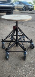

The seat i cut from 3/4 ply wood scrap I had in my shop using my router.
Still to come..
I ordered caps for the round tube so it looks complete
Upholstery on the seat with the Venom logo. I already spoke to an embroidery shop and they are going to sew this on it
www.etsy.com
And paint!
