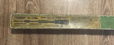

Here’s my Dad’s 130A, dating I think from the late 60’s / early 70’s. Still in it’s original box, still recognisable as a “North Bros” box, rather than a Stanley.D1D990A7-8F88-48E9-99FC-F03244FBF4E9.jpeg59EFA35F-69A8-4A77-B613-B31ABD00EA32.jpeg

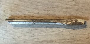

I've found quite a few Yankee spiral drivers out in the wild, but the various size bits are hard to find. Over time I grab any bits I find and then spread them out to the appropriate drivers so now pretty much all of my Yankee spirals have at least 2 or 3 bits so they can be used.

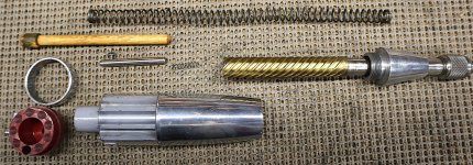

Maybe I can get some life back into this one. Currently completely stuck, forward-fixed-reverse lever moves freely, feels “disconnected”. Got it soaking in some solvent right now. Grub screw came out effortlessly.
Kind regards,
Olli
Once the grub screw is out the cover should slide forward / downwards. Push the selector in and slide the cover over it.
If it’s not moving it’s probably because it’s gummed up with old oil, which is probably what’s causing the problem anyway!
Your solvent soak should sort it out!

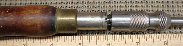

I have been sorting through my bins of spiral ratchet screwdrivers and found a few interesting things. One of them is a variation in the chucks of the Yankee screwdrivers. I have dozens of them with similar chucks, and ONE with a slightly different chuck, and that is why I am posting here.
Here's my question: One of my dozens of Yankee screwdrivers has a chuck like the picture on right, and all the rest are like the one on the left. he pictures were taking while pulling the chuck back to insert or remove a bit. The uncommon one (on the right) has a circlip at the end that keeps the chuck in place, and all the others have part of the chuck that stays in place at the end of the driver and stops the chuck from coming off. Does anyone else have a Yankee with a chuck Iike the one on the right? This one is a Stanley Yankee 130A, and my others range from pre-1900 unmarked tools to late 130A of various ages. I've also looked at other sizes and vintages of Yankee screwdrivers.

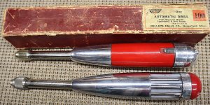

Something interesting. At the top is a Millers Falls 100 push drill commonly referred to as the Buck Rodgers model. Below is one that has similar lines, but the construction is different using a transparent sleeve to show the bits and the top cap rotates to the desired position.
On the silver band between the red cap and clear tube it is marked "CRAFTSMAN" and then a F inside a circle, indicating a Millers Falls product for Sears. Have not found a similar one with the M-F name on it. The clear tube on mine was pretty scratched and blackened after all these years so replaced with a new one.
