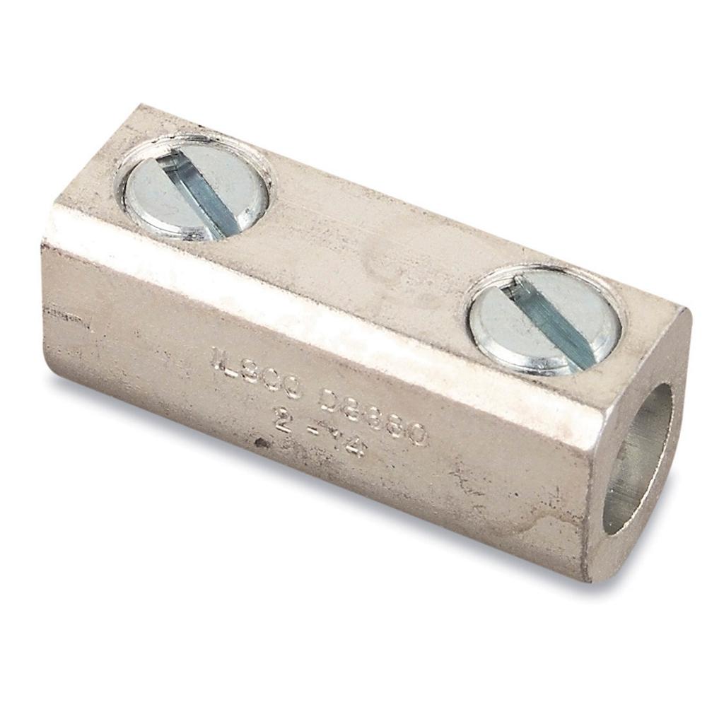

You have multiple choices for splicing
An NSI Polaris connector, which doesn't need insulating (it's also the most expensive)
A split bolt connector rated for AL, that requires lots of taping with at least 2 types of tape.
And a splicer/reducer that also need taping though not as much, because of it's shape, as the split bolt.
I recently used some of those when I replaced a taped split bolt connection. Instead of tape, I opted for 1000V rated heat shrink. The connections were much more compact. Still won't fit in an LB though.
