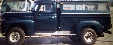

I shop-built the canopy for my 1953 International R120. The canopy was custom built for an 8 foot box and an IHC only box width. I also made the canopy to match the taller height of the cab.
I live in a wet climate, so I inquired about spray insulation.
The company recommend to me had employed a bunch of jack-asses.
They totally filled the canopy with urea formaldehyde expanding foam then refused to give my canopy back until I paid what was double the agreed price, in cash. I did get revenge. When management became aware of my situation, they refunded the money I had paid and fired the jack-asses. I was left with two days of hand scraping the foam off. I went back to the RV repair shop that made the recommendation so they could be aware.
