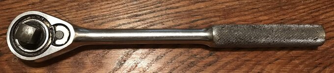

I’ve been looking for a 3/8 Tri wing selector marked “Bonney” for a long time. I’ve seen exactly 1 available to purchase in the past year and I missed it.
I never gave it much thought when I first bought my Bonney set in 1983 as the 1/2" 3/8" and 3/4" ratchets were all single selector lever and the 1/4" was a try-wing selector. Years later I finally found out that the Trike wing was the older ratchet.
LesserSon
Feb 7, 2016
5,123
PA USA
The succession of Bonney ratchet models has been an on-again, off-again interest to me. Actual users who recall buying them new are a good dating resource. Trade magazine advertisements, too. Catalogs have two limitations: the illustrations persist after design changes occur, and the availability of free, scanned catalogs is limited.
Yesterday, I received an AA707H.
27AA5A0F-A21A-490F-A4BF-8CBD7F0CA141.jpegI do not see it listed in catalogs from 1963, 67, 77, 81, 86, but I do see it illustrated in 1967, p13(p15pdf), in the sets where the A-702K is specified. Since I do not see it in the 1963 catalog, I suppose it was offered sometime 1964-1966.
1967 is also the only catalog where I see the tri-wing selector on the 702K, the single-rib selector version persisting at least into 1986. If it really only sold with that selector for one year out of two decades, that would be a significant reason why it is a unicorn. In my collection, I have the 3/8dr triwing, but not the 1/4dr or 1/2dr.

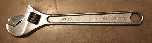

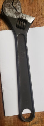

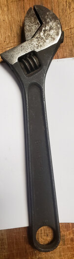

Here we have a 6" adjustable, black oxide finish BonECon with "Made In USA" and a W forge mark on the shank. 🤔 Didn't another supplier make the adjustable for Bonney? Maybe they just slapped the "made in usa" instead of just plain old "usa" for Bonney?
LesserSon
Feb 7, 2016
5,123
PA USA
I do not know the manufacturer of that adjustable. I agree the “W” is probably a clue.
Bonney outsourced adjustable production. A major supplier was Utica, which also supplied pliers - for decades prior to Utica (Kelsey-Hates) purchasing Bonney from Miller Mfg in 1964, after which it is pointless to distinguish between “them” (nor Herbrand, nor Torque Controls after ‘68, nor Diamond after ‘81).
However, at times, or for specific tools, Channellock, Crescent, Danielson and others made pliers or adjustables for Bonney.
Adjustables with unreinforced hole have not been an area of interest to me, so I just don’t recognize it. The jaws are hex-head optimized rather than square-head optimized, as many Utica and Danielson/Proto adjustables were. Bon-e-con is probably from the 1950s, but again, that line has not been an interest to me.

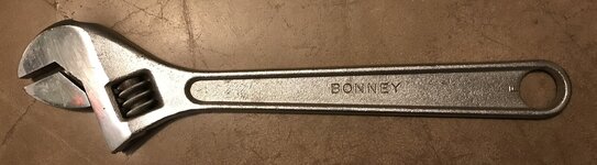

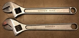

I do have an adjustable that may be of interest, though. Bonney-branded, fully chrome-plated, presumably the same era as your Bon-e-con. Note the “F” where yours has a “W.”
It is not the style I prefer; I believe my grandfather purchased it new, so during the Miller Mfg years, when a supplier other than Utica seems most likely. Last pic is contrasted to the same model number in the Utica style.
Username already in use
Sep 4, 2015
2,177
Flat bottoms are likely Pendleton and the hex bottoms are likely crescent or Diamond. The tell with the hex is how thick the head of the wrench is. Big thick heads are probably cresent made. 🤷🏻‍♂️
16,767
Here is the picture that Snapmom posted some time back of that set. Those wrenches are both shown in the lower row, right of center. Hopefully she already has those in her set. Edit. I just re-read her thread and it looks like she has those covered.
