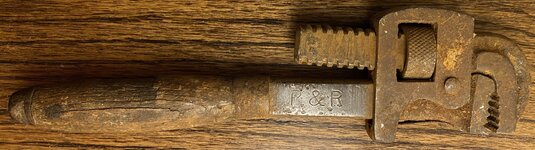

IMG_9534.jpegPicked up two Bonney items today, a 3426 tappet wrench from Jan1949 and an 8” Stillson from somewhere between 1909-1921.
IMG_9535.jpegWhen I scraped rust from the reverse side of the Stillson, “P&R” appeared. (The photo makes it look a bit like “R&R”, but I don’t think so.) EDIT - here’s another look at a different angle:IMG_9537.jpeg
I had hoped this would help to narrow the dates, but it doesn’t. “Philadelphia & Reading” Railroad was established in 1833 to transport anthracite coal to Philadelphia. It grew through acquisition and diversification until forced to break up 1Jan1924, adopting the moniker “Reading Company,” though retaining the “Philadelphia & Reading” among other Lines, until bankruptcy in 1971 and Conrail absorbtion in 1976.
What people call “railroad wrenches” are often 3-4 feet long, so I wonder what this 8-incher was used for…maybe the coffee maker? Anyway, at 102-114 years, it embodies the old inter-related industries of Coal, Rail and Steel in eastern PA.

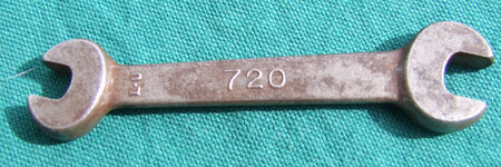

Is this small (3 1/4") spanner made be the same Bonney company? I can't find anything that looks similar. DSCF9568R.jpgDSCF9569R.jpg
30,864
That style - simplistic forged-in branding and size markings, all on the top- and flip-sides of the shank - is very characteristic of their economy line and wartime production DBE wrenches, which is consistent with the 1943 date code. But I don't ever recall seeing a DOE wrench in this style before. On such a small wrench, with that ISN, and nothing on the major or minor jaws, it's a really sweet looking wrench.
Nice find.
