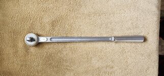

Looks like I got a c1950 CC10 roller cabinet and 1949ish tool chest for $20 today. There is no original branding that I can see, so maybe it wasn’t Bonney. It did recent duty in a bicycle shop. Dunno if the Shimano logo will come off painlessly or not.
Happy anyway.
