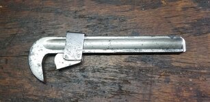

Google rexos spanner for a ratcheting wrench but like Carpenters first patent it uses a swinging jaw which keeps these off Lugs’ chart.
There is even an adjustable akin to a crescent shifter.
edit, image of the business end added, 3/4 BSW =33mm =1 & 5/16”
P
30,999
We actually thought it a happy and tidy coincidence that the oldest (Carpenter) and youngest (Evans T&R) wrenches in the Lugzsonian providing a ratchet action happen to be the adjustable versions of each inventor's same basic design, which made for a nifty photo.
To be clear, though, even though it's an adjustable wrench (and therefore having what inventors in this family called "yielding" or "loose-jaw" members), the shape of the opening made by the fixed jaw and the dynamic jaw to adjust it to different size nuts or pipes uses the same principle that Carpenter applied to a fixed open end wrench, and had as its sole stated objective and claim, a wrench "capable of being moved to get a fresh hold upon the object being acted upon without removing the wrench from such object."
As does the Rexos!
From the patent: "Upon turning the wrench back, the jaws a and b are removed from the nut, while the pivotal jaw member still embraces the nut on three sides. On the pivot of the movable member an abutment x is provided, which permits a turning-back of the fixed jaws a and b so far only that the key can turn over the nut, whereby the ratchetlike action is obtained." That pivoting jaw is there explicitly to allow a backswing and another grip on a different flat, in sequence, again and again, without removing the wrench from the nut, not for self-adjusting on different size nuts, but to achieve what they claimed: "a novel wrench of ratchet-like action".
Patent GB191019234A, granted June 21, 1911, to Paul Meyer and Max Nolden, Solingen, Germany. No citations.
Thanks for being it to our attention! :thumbup:

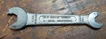

SECOND WAVE cont.
SIMPLEX -- FASTNUT -- REILLY
A selection of classic style Simplex wrenches in several iterations using at least three different material specs:
Chrome Vanadium
Nickel Molybdenum
Hi-Nickel Molybdenum
and three different patent markings:
January 1, 1924
1,642,805
January 1, 1924 & April 27, 1927.
I have five different combinations of patent info and material. There may be more.
Wrench numbers include:
10
11
12
13
14
15
19
32
Three materials, three patents, and eight part numbers makes 72 potentially different wrenches.
And, there are variations within some of these.
And, … some are seen marked Frank Reilly rather than Simplex.
I don’t think though, that the situation, from a collectors perspective, is quite that bleak.
I only have, or know of, less than 20 different combinations total.
The wrench part number is usually forged into the panel.
The die-makers were surely kept busy.

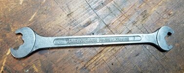

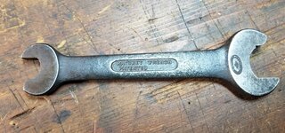

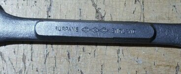

Peugeot Freres, or the Peugeot Brothers, is an interesting story. @Outlawmws is a fan, and maybe we can get back into his good graces after that Helleracious false start by telling it.
The name refers to Jean-Pierre and Jean-Frederic Peugeot, who in 1810 converted the family flour mill to a steel mill. They began making all kinds of products, from coffee grinders to clock mechanisms, including tools. In 1847, due to severe disputes between several cousins who ended up with control of the company, Peugeot Freres split into a few different business entities, making different products, including the automobile and tools, which the other entities were prevented from making. (If anyone else is picturing men with classic handlebar moustaches histrionically shouting French epithets at each other across a big oak table set up with fine French food and wine, you’re not alone!) They were reunited again as Peugeot Freres in 1910. (Now they’re older and all smiles and shaking hands across the same table!)
“Surpans” is from two words, sur pans, which translates quite literally in English as “on flanks.”
The “Bte.” on the shank of the Peugeot Freres wrench is an abbreviation for “Brevetes”, the French word for patented.
Unfortunately, no indisputable evidence of which patent it refers to is readily available in the public domain as far as we know.
There are some good clues, however. In 1954, Fritz Diebold (New Britain and Blackhawk “Nutmaster” wrenches) cited Henot. In 1964, Alfred Kavalar (Kelsey-Hayes, including Utica, Herbrand, and Bonney “Loc-Rite” wrenches) cited a later French patent (1,033,792 / Raymond Petit). It’s very likely that the Surpans patent is one of those. Which one has been an open question.
Neither patent uses the words “sur pans” verbatim. The Petit patent does not cite the Henot patent. As others have noticed, the “VANA” in “VANA-LION” undoubtedly refers to vanadium. Many tool makers were using vanadium in alloy steel in the 1930’s, so it’s possible the wrenches date to the 1930’s. According to car collectors, however, the wrenches were part of the kit put in the trunks of the Peugeot 203 and other cars made in the 1950’s.
Another clue comes from Surpans wrenches made in England, ostensibly under license. The “BNT” on them refers to Brades, Nash, and Tyzack, which did not even form as a company until 1951. See the purloined photos below.
P
30,999
Finally, and most convincingly, the Curator has found several trade mag references that indicate the Surpans wrenches were first introduced to the market in 1953.
Surpans announcement Electrical trade mag 1953 page 1.jpgSurpans announcement Electrical trade mag 1953 page 2.jpgSurpans Aukland Ag Trade Mag 1953.jpgSurpans Foreign Commerce Weekly sales agent ad 1953.jpg
Therefore, we have fairly confidently assigned credit for the Peugeot Surpans to Raymond Petit of Paris, France.
Technically, these wrenches, which always seem to get thrown into the mix in this conversation due to their unusual milled opening, were not designed for ratcheting; they were designed to apply force on the flats to prevent marring of corners, but their design lends themselves to riding over the corner on a sort of backswing.

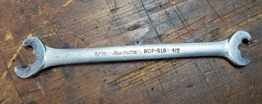

THIRD WAVE Final (Diebold)
New Britain gave the design they licensed from Diebold one of the cooler brand names in this genre and openly advertised the fact that it was a European innovation. They used the same name and marketing on their Blackhawk models as well. We don’t have much to say about their lobular design except the obvious: they look very similar to the Petit Peugeot “Surpans”. Very similar as in nearly identical. Which is a little odd, because Diebold did not cite Petit, he cited Petit's earlier countryman, Henot, as well as Denham ("Erie"), and the granddaddy of them all, Carpenter.
But note that Petit was earlier than Diebold, who was earlier than Kavalar, who was earlier than Knudsen et al. If anyone deserves credit for the modern era of end wrenches of this type, it’s Peugeot, not Snap-on.
The “Surpans” are milled just a little thinner than the “Nutmasters” on the outer jaws.
Distinctions between the Petit-Diebold (“Surpans”-”Nutmaster”) pairing, like the distinctions among wrenches in the Wilder-Ward/Evans (“Speed-Hed”-”Lockjaw”/”Speed Wrench”) lineage, which I have yet to get to, are so imperceptible they strain either the Curator’s incredulity in the examiners’ definition of “novel” or his understanding of patent law, and, to be frank, we have no interest in resolving it.
NB Nutmaster cat excerpt 1958.jpgPatent Diebold 1.jpg20210220_173305.jpg20210220_173239.jpg20210220_173245.jpg20210220_173248.jpg20210220_173254.jpg
