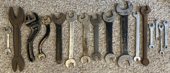

Picked up a few more yesterday morning at Leesport flea market, all for $18.
Two CV 408 tappet wrenches, date code AP (Jan1924). Interestingly, I already had exactly one 408, and it has the same date code.
Full polish LocRite broach 1-1/16” 1171 combo. I have seen these in similar sizes and been unable to negotiate them down below $20!
No3 fixed jaw pipe wrench with “Bonney Vise and Tool Works Inc Allentown PA USA” and no date code, so 1909-1921.
BW10 adjustable, Utica-mfd, plain finish.
6” S-adjustable with shield broach. I have occasionally seen this size, but never for less than 3x what I paid. I already have an 8” with this style broach, so only my way to a collection.

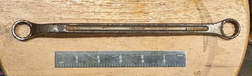

7/16 to 15/16 same size on each end box wrenches. Offset and straight. Still have the little label on them. Date codes are T,U,V (1928 - 1930 ) and it looks like the correct box. I wonder if a set from the factory would have date codes from 3 different years.
Edit: The box looks like the No 34 set, but it would be missing the 3 small wrenches. It has all the wrenches for the No 33 set.

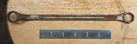

Funny, I pulled one of these from last weekend's shop cleanout, a 2820 5/8" Bonnet Zenel. Just finished taking pix a few minutes ago, so the print may still be a bit damp.
Again, if this finishes a set for someone, holler. I'm a long way away from a set, unlike ararat.
30,889
Short answer:
Based on my collection, I believe your wrenches are original to your box and vice versa, and the alternatives (a PO or multiple PO's bought the set, some of the wrenches, and then some replacements in a three-year series of stages) is far less reasonable. I have several sets that span two years. Granted, three years is quite a stretch, but not those three years, in particular. The Great Depression started in 1929. I have several Snap-on pieces in the 'Great Depression drawer' of my Snap-on Wing that have 1928, 1929, and 1930 date codes, and even one with all those and a 1931 date code! In that case, they kept re-coding them until they sold, years later. In your case, I would speculate that the pieces were sitting in unsold inventory until they were plucked out of their respective bins and assembled for that set.
Longer answer with examples to follow...
30,889
Longer answer:
As you may recall, @ararat, I have three complete Bonney wrench sets in pouches and I have no reason to doubt their provenance together: a No. 25 engineers wrench set, a No. 412 tappet wrench set, and a No. 20 -ZENEL- miniature engineers wrench set.
None of them have 'perfectly matching' date codes (i.e., from the same month-year or even from the same year). Close, but they are all "mixed" in terms of date codes.
The No. 25 engineers set dates codes are "CV" (1027-C), "DV" (1731-A), "GV" (1033-C), "GV" (1028-S), and "FU" (1723). So, produced between early to mid 1943 and then in early 1944.
The No. 20 miniature engineers -ZENEL- set has three wrenches with an "ET" code, and the rest too hard to read. Probably all 1942.
The No. 412 tappet set dates codes are "LP" (404, 405) and "EQ" (402, 403), so, late 1924 and then mid 1925.
I also have a No. ES5 extra small sockets & tools set in its original steel case.
This is a prewar set. Most of the tools are original to the case, but are not date coded. The box wrenches (E40, E42, E44, E46) have date codes “FM”, “HM", “IM” and "IM", so, all made in 1935, but, note, over a 4-month span. (The other wrenches will be no help here, they are all 1947 replacements.)
As I alluded to in the short answer above, and as I have discussed on this thread before, I think the mixed date codes we see in Bonney sets are a function of an operation in which the manufacturing (drop forging, finishing, and storing) was always ahead (in considerable surplus) of production (assembly, packaging, and distribution) and sales. In short, I believe Bonney tools in the 1920's and 1930's were in fact routinely sitting around for some length of time - weeks, months, and sometimes many months spanning two years before they were assembled into sets (pouches, boxes, etc). When that assembly happened, I don't believe the assemblers cared about date codes, and inevitably, some would be the same month-year, some might be a few months behind, but the same year, and, less commonly, some might be several months and possibly a year behind.
I don't believe I have ever seen ANY Bonney set of tools in a pouch or case with all the same exact date codes (from the same month-year). It's possible. I'm just saying it's not at all uncommon to see them more varied.

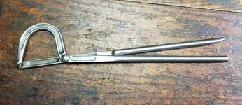

Snagged a couple Bonney pieces at the flea this morning.
Up first, these No. 2680 brake spring pliers. I've found and posted a few of these before, moved on to other collectors years ago. They were first introduced in the 1939 catalog. Some are marked PAT PEND on the horseshoe, some are marked with the patent (2,264,391), which was granted in 1941. They are featured in WWII Ordnance Dept maintenance catalogs. I've had them with prewar, wartime, and postwar date codes. This example is 1953 (E:Q).
