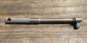

Using some free time to organize my tools. Didn't even know I owned any Bonney tools.
Must have been my dad's. He was into HVAC.

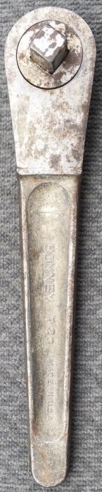

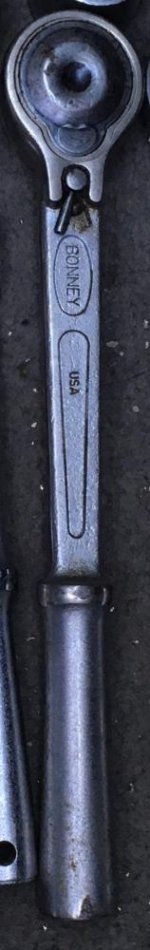

Picked up another 3/8 ratchet. This one is at t 707 my other is a tt707. Is the tt a Bonney con version? Both pat pending. Just curious about the distinction.
Oldtuleguy
Nov 4, 2017
10,486
Couple pics
LesserSon
Feb 7, 2016
5,121
PA USA
No, they’re different models, but both Bonney. Catalog debuts are three years apart (1960&1963). Pretty sure the mechanism is identical or close, but the selector switch and handle designs are different.
Some of the BonECon stuff retained design cues like the tapered/conical grip, but is generally plainer and boxier. Ignoring the mechanism, I think there is a natural progression to the handle design.
That “Outlined” handle on the T707 has its origins in the earlier (1957) “Streamlined” handle on the T701. Just a bit of a split in the early sixties of whether to go with a straight selector switch or the in-line dial switch.
Could be the “pending” refers to the mechanism on the T707, and the selector or handle (probably a design patent, if just the handle) on the TR707. Just a guess; I don’t recall actually researching it.

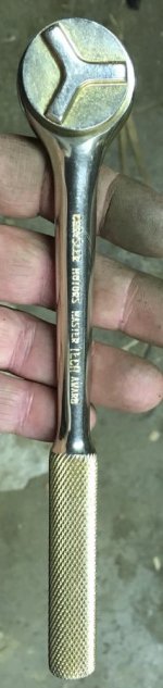

16,766
I don’t collect Bonney but this PWA1397 3/8” drive breaker arrived today in an eBay S-K lot. It’s quite different looking than the Plomb version I got earlier in the week. It was IDed for me as likely being Bonney by the experts.
