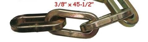

Any one ever heard of and know a source for square link chain ?
The links are made out of square stock instead of round stock. The edges of the links supposedly bite into round pipe when you wrap it around a pipe and won't slip when you are pulling at a near horizontal (to the pipe) angle.
Hundreds of years ago, anchor chain was made like this.

I have used Square link chain like in the photo at the top before and I have used square link chain like the photo at the bottom, one for mooring buoys one for garden fence.
However when using a chain or indeed a rope to turn something it is the amount of wraps or turns around the cylinder being turned that makes the difference not the shape of the link. Square link has all but disappeared from the marine world (as shown in the top photo) as to handle it requires you to change the gypsies on winches etc which is a pain in the ****. The manufacturing of square link is cheaper though so its used in DIY and home use quite a bit (bike security chains/ fences).
BTW the bottom photo shows welded link which is much weaker than forged link.
In the UK we can buy the stuff your looking for in B&Q which is our version of Home Depot or in most hardware stores so they would be my first port of call.
Thanks for the feedback, especially the tip on welded versus forged !
The application will be for pulling round steel pipe, between 2-4" in diameter. I was told that with the chain wrapped around the pipe and then placed back over itself with a slip hook that square chain would "bite" and not slip like regular chain when the angle of the pull is nearly parallel to the pipe.

Do you mean like towing behind a truck or similar?
I don't think the link type will make a difference as the friction comes from the wraps and choke not the edge of the link. The size of the link will make a huge difference though. If the links are to big to wrap smoothly around the pipe then you will get poor contact between the chain and pipe which will reduce surface to surface contact. Friction is king and friction comes from the amount of total contact not sharp edges.
Its hard to explain without pictures but what you need to do is choke the chains on the towing side of the pull.
So if you place the hook closest to the truck then wrap the chain in the direction moving away from the truck (4-5 turns at least) then lead the rest of the chain across the wraps in a diagonal direction and back the way you just came parallel to the pipe and pass it through the hook and then back to the truck. so that when pulling you pull from the bottom of all the turns.
The type of link makes no difference and in all honesty over short distance I would use rope tied with either a rolling hitch or timber hitch. If your lifting the pipe into the air I would use webbing lifting slings which have been inspected. choke the sling at each end of the pipe and lift in the middle. OR even better proper pipe slinging hooks.
