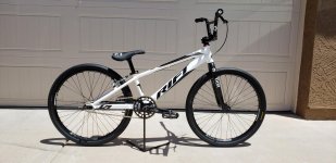

Just got done putting this together.....
- Rift Pro 24" Frame
- Sinz 175mm cranks
- Answer wheelset
- Maxxis DTH 24x1.75" tires
- Shimano brakes
- Box Components bars, forks, and small parts
I got tired of just watching my 5yo ride, so I decided to start my BMX career 30 years late. My mountain bike riding buddies are speculating I break myself on the first double. I don't disagree.
