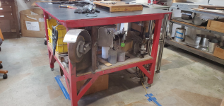

I am building a new workbench and want it to be both stable and one-person mobile.
It doesn't have to be easy to roll since it will be mostly stationary, but I do need to be able to push it a short distance a few times per year.
However, it absolutely needs to be totally stable and solid when in place. I don't have much patience for benches that rock and wiggle when I'm trying to work.
My prior experience working on any bench with conventional locking casters is that (even when locked) there's enough play in the mechanism and/or the point contact with the ground that there's still noticeable movement from the work surface.
I'm familiar with the type where the wheels retract up and then deploy downwards when you step on them. these look like a good solution from a stability standpoint but I'd prefer not to have the assembly sticking out the side of the legs if I can avoid it.
Does anybody have experience with this monolithic style of leveling/locking caster that extends a foot below the wheel? If so, do you get any noticeable play once the feet are down?
I like the idea of having a leveling function integrated into the locking caster, but want to make sure they're not going to be all wiggly in actual use.

My welding table weighs most of a ton. When I got It had big 1-1/2"bolts under the legs to level it
I added the casters but I offset them
If I screw the bolts up about 1/8" I can move it around alone. If the bolts are screwed down 4 men couldn't move it.
Maybe that idea will work for you?
I do have to sweep the floor before I move it as even a dime will stop a caster from rolling.

After I move the table to where I want it I screw the bolts down so they raise the casters off the floor about 1/16". Don't need jam nuts - they never move.
